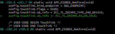

Only code difference between SED and ED is that SED does not set ZCL_TL_ZBINFO_RX_ON_IDLE flag on function APP_ZIGBEE_NwkForm().

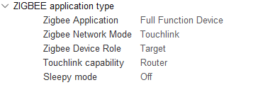

Target Project (TL router)
Imported Zigbee_OnOff_Server_Coord and Changed Zigbee Configuration as below

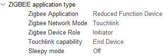

ED project (TL connections are OK)
Imported Zigbee_OnOff_Client_Router example and Changed Zigbee Configuration as below

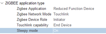

SED Project (TL connection fails)
Imported Zigbee_OnOff_Client_Router example and Changed Zigbee Configuration as below (enabled CFG_FULL_LOW_POWER)
Results are Target - ED is OK, but Target - SED fails.
Code difference between ED and SED is the greeb line in below image does not exist in SED code generation.
