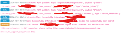

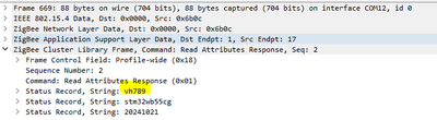

2024-12-01 10:51 AM
yes I have resetted the devices that were involved in the test and still no success. What kind of logs can I provide to you?
In my coordinator interface I can see the following:
And my controller only outputs the normal join process via UART.
Thanks
