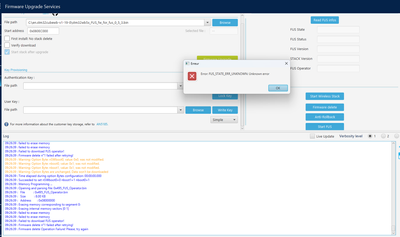

I have some trouble with a STM32 MCU.
I was playing with the radio firmware and delete it.
From now on, I'm unable to reprogram it, I always get this kind of error ( FUS_STATE_ERR_UNKNOWM) :
FUS seems to be in bad state :
By comparaison with a working board, I find that a secure flash address has been configured to this MCU and it overlap the FUS/radio firmware address :
Now I'm trying to revert back this value to the factory 0xF4 value but I'm unable to do so.
STM32CubeProgrammer won't accept to modify bits in the security option 2.
Even with the factory reset command using STM32_Programmer_CLI software it didn't work (I don't remember the exact command)

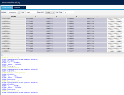

1) Connect using STM32CubeProgrammer, make sure no RDP or write protection are activated in option bytes
2) Perform mass erase (to be sure about FW running in the MCU and be sure FUS operator is detecting right FW in memory)

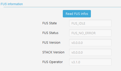

3) In RF tab of STM32CubeProgrammer, activate WB command "Firmware delete"
- after command finishes, you shall see 0xf4 in SFSA
If not successful, please post back your error log.

2) Perform a mass erase :
3) Trying to delete radio firmware :
And got an error...
Any other clue ?
Lubos KOUDELKA
thank you for posting pictures showing your steps. The last one with error shows also the log. From the log I can see operations fails, when STM32CubeProgrammer is erasing first two sectors (8 kB starting 0x08000000) to load FUS operator, but erase of those 2 sectors fails. Also before that is in log "failed to erase memory", but not visible to which commands it's tight.

Please ensure your option bytes setting is correctly written in MCU. When you do power cycle (disconnect and connect USB cable), can you still see the same content?
