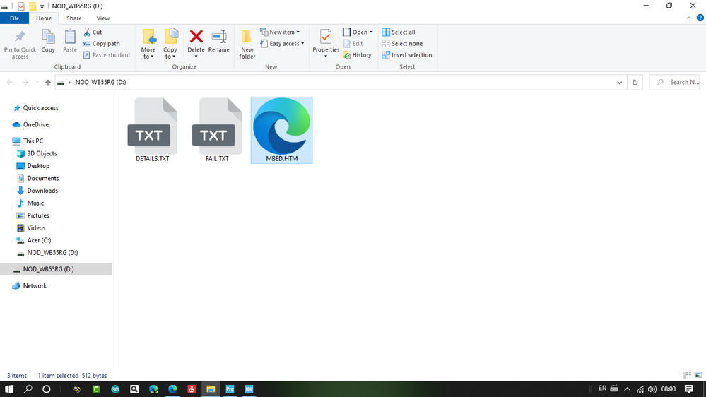

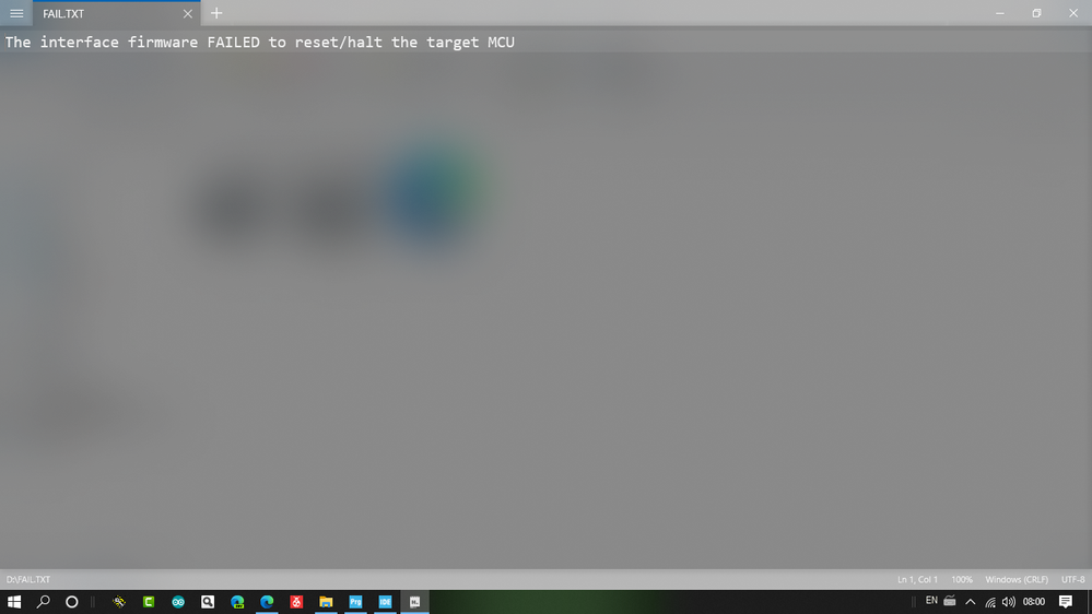

When i connect the STM32WB55 with PC via USB cable on ST-Link Port,
This window is prompted on my screen with Fail.TXT file showing message as shown in PIC0693W000007B1VAQA0.png
what can be the reason and issue?
I have connected WB first time to my PC
KGupt.1
Well yeah above problem was coming because i have not connected the connectors on Jumper 3, so My MCU is not getting Powered from power supply thus it is getting error like this
