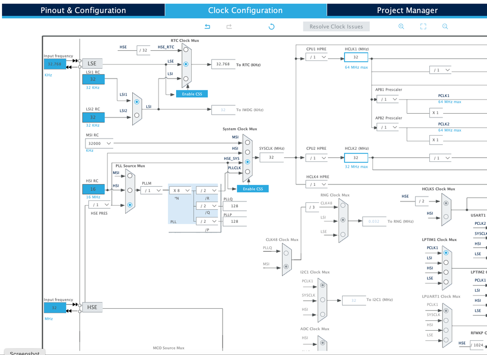

We're faced to a problem when dealing with LSE clock to handle RTC backup using a supercapa connected to the VBAT pin.

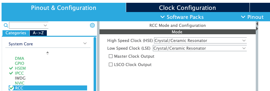

The LSE configuration under STM32CubeIDE:
The Clock Configuration function:

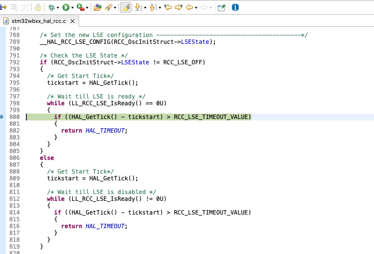

And when we started the program we get stuck at this line and then it goes in a timeout error:
We noticed that we get this issue only when the VBAT pin is set to 3v.
