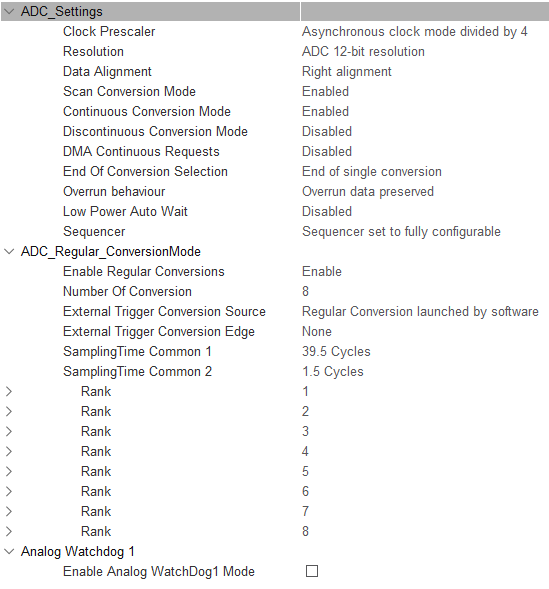

I am developing a small module with the STM32WB10 and I need to do 10 ADC conversions (9 external and the internal temperature).
However, I can only get the DMA to do the 8 channels configured in the regular channel ranks (Number of conversions = 8 is max in the CubeIDE configurator).
How do I make the DMA handle the last 2 channels aswell? if it is at all possible?

Hello @Ugilten​ ,
The STM32WB can only scan 8 channels when the sequencer is set as fully configurable. If you want to scan more than 8 channels you need to set the sequencer at "not fully configurable".
It's explained in the part 15.3.8 Channel selection (CHSEL, SCANDIR, CHSELRMOD) of the RM0478 rev4.

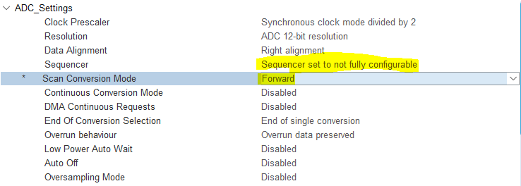

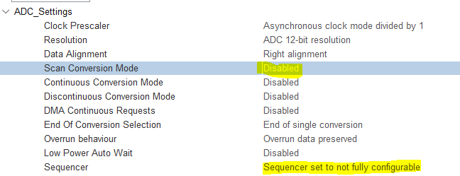

You don't need to implement the scan mode by your self. There is a reference in cube Mx. As I said in my previous message. If you want to scan more than 8 channels you need to set the sequencer as "Sequencer set to not fully configurable". This option is present on the ADC parameter settings.
Nevertheless I observed a bug on cube MX. Normally to config and set the ADC as not fully configurable. The user needs to select to set the sequencer as "Sequencer set to not fully configurable" and after selects the direction of the scan in the "Scan Conversion Mode" like in STM32G071RB cube MX:
But in the STM32WB1x when the user sets the sequencer as not fully configurable, the scan conversion mode stays stuck at "Disable".
0693W00000Npqa0QAB.pngThus when you generate the code. Normally in the ADC setup function (static void MX_ADC1_Init(void)) you should have this line :
 hadc1.Init.ScanConvMode = ADC_SCAN_DISABLE;
Then to activate the scan you just need to replace ADC_SCAN_DISABLE by ADC_SCAN_DIRECTION_FORWARD or ADC_SCAN_DIRECTION_BACKWARD following the desired direction.

Ok, Now I finally got it working.
So just for my own peace of mind I will post my findings here so I can do it again in 6 months :beaming_face_with_smiling_eyes:
As @Simon.T​ mentioned above, I had to set the direction of the scanmode, but also register the channels it needs to scan in the CHSELR register by using the LL function
void LL_ADC_REG_SetSequencerChannels(ADC_TypeDef *ADCx, uint32_t Channel)
after the HAL setup of the ADC.

I have just been digging through the code in the HAL_ADC_Init() function in stm32wbxx_hal_adc.c and it only handles cases where ScanConvMode is ADC_SCAN_DISABLE or ADC_SCAN_ENABLE.
In both of these modes it sets CHSELRMOD = 1. In any other case this bit is 0, and that is what it makes the ADC/DMA work in the Not Fully Configured Mode.
Thus, to make sure it works after modifying the .ioc file and rebuilding the code from CubeMX, make sure to add these lines in user code ADC_Init 2 section
LL_ADC_REG_SetSequencerConfigurable(ADC1, LL_ADC_REG_SEQ_FIXED);
LL_ADC_REG_SetSequencerScanDirection(ADC1, LL_ADC_REG_SEQ_SCAN_DIR_FORWARD);
LL_ADC_REG_SetSequencerChannels(ADC1, LL_ADC_CHANNEL_2 | LL_ADC_CHANNEL_3 | ...);
