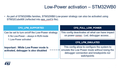

All BLE examples part of STM32Cube_FW_WB0_V1.3.0 already support low power mode while doing BLE.
All those BLE code example integrate  a "low power management" - You can select desired low power mode using CubeMx or in file app_conf.h
CFG_LPM_SUPPORTED => set to 1 to activate low power
See more details in below slide :
This settings should allow you to reach lowest low pwer mode whith RF active ( the STM32WB09 will enter low power mode between 2 BLE events - of course RAM and Low speed clock  are maintained  during this period - everything else is switched off)
