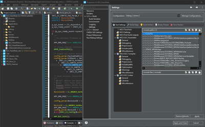

‎2024-06-24 2:01 AM - edited ‎2024-06-24 2:44 AM
When cloning or downloading the STM32Cube_FW_WB_V1.19.0 the examples comes with relative include paths (../)
Opening the Compiler Include Paths looks like this:
When copying a example project the resources should therefore be included as well. This is done in the .ioc file by enabling 'Copy only the necessary library files'.
Afterward the relative include paths should be changed to match the current include paths of the project.
Go to Properties > C/C++ Build > MCU GCC Compiler > Include paths. Update these acording to your project setup. The default setup that matches the folder structure of STM32Cube_FW_WB_V1.19.0 is shown on the first screenshot.
