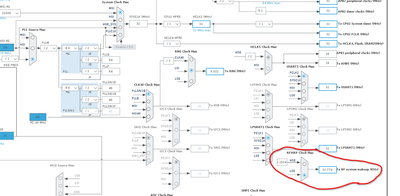

I experienced the same issue. Just mentioned in this post https://community.st.com/t5/stm32-mcus-wireless/stm32wb-cpu1-stuck-waiting-cpu2-at-init/m-p/580103#M16082, the problem is caused by that, the clock of the application is configured on the HSE and the bootloader is on LSE for the RF system wakeup. So configuring the clock source of RF system wakeup to LSE in your application is a way to solve the problem.
TBran.3
Holy smokes dude, that was it! Thank you so much! I've been banging my head against the wall for so long.
For everyone else, just to be clear, here is the setting in CubeMX that needs to be modified (must be LSE, not HSE):

Can confirm! Changing the RFWKP Clock to LSE fixed my issue, I can now boot from normal firmware to OTA again!
I just want to add that if you have no LSE you can also, like any other project, reconfigure the bootloader to use HSE instead
https://community.st.com/t5/stm32-mcus/configuring-stm32wb-for-bluetooth-le-without-an-lse-crystal/ta-p/49465
That's something I already did successfully in the past. Using HSE in an application which DOES have an LSE is something you should not do normally since it will increase power consumption n-fold.
