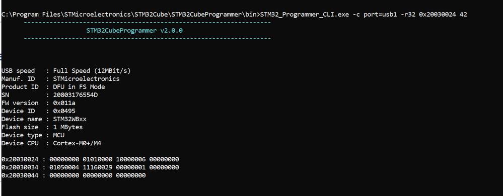

Stumbling through the procedure described in app note AN5185 - ST firmware upgrade services for STM32WB Series using eval board MB1355C (STM32WB55). On page 3 of AN5185 it says:
In order to check if FUS is running or not, the following options are available:
• Send a single FUS_GET_STATE command and check the return status. If it is
FUS_STATE_NOT_RUNNING then FUS is not running.
• Check the SBRV option byte value:
– If it is 0x3D800 then FUS must be running
– If it is different from 0x3D800 then FUS is not running
• Send a wireless stack command:
– If it is acknowledged, then FUS is not running
– If it is not acknowledged, then FUS is running
• Read the shared table information:
– Read IPCCDBA (in option bytes) to get the shared tables start address in SRAM2a
– Get the device information table address
My question is just trying to get me oriented. The command line program STM32_Programmer_CLI.exe has an option -fusgetstate, whereas the app note says to issue command FUS_GET_STATE and mentions a return value like FUS_STATE_NOT_RUNNING. Is the capital letter nomenclature a different concept than the STM32_Programmer_CLI.exe nomenclature? How would one "Check the SBRV option byte value"? How about "Send a wireless stack command" and most importantly, "Read the shared table information"?
Sorry probably dumb questions but I don't understand the context of these terms, trying to sort out basic things like what is referring to the Cortex M0, what is in the Cortex M4, what is in the module, what is in APIs, and what is in the CLI utility app...

you can read the option byte IPCCDBA with st Cube Programmer, probably its 0x00 (offset), so you can read with stCubeProgrammer_CLi.exe the memory from the start of SRAM2a (0x20030000+IPCCDBA value(0x00), the first 42 bytes are device info table, located in SRAM2a start address , so execute:
STM32_Programmer_CLI.exe -c port=usb1 -r32 0x20030000 42, the you have te result.
Hope it helps
Regards
AValt.1
0693W000000UMywQAG.pngSorry, i guess its like so, but i dont understand why FUS version seem to be 0x00000000, Ble Stack is working, and i didnt remove it.Wireless Stack version its in memory address 0x20030034

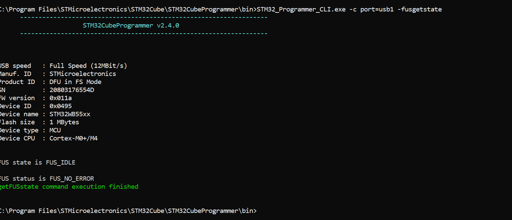

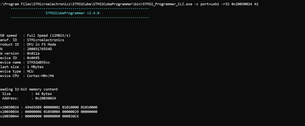

Finally solved it, i use St cube programmer to read Fus version, at first it returned FUS_ERROR, then i try again, and it returned the correct installed version, so i read device info table again via cli commands and everything seem to be ok, check it:
AValt.1
Hi again, i finally solved it, the reason why i read FUS version 0000 its beacause you have to send 2 fusGetSate commands, to activate it, then you can read the info, as described in https://www.st.com/resource/en/application_note/dm00513965-st-firmware-upgrade-services-for-stm32wb-series-stmicroelectronics.pdf PAGE 11.
I also did it via cli commands:
