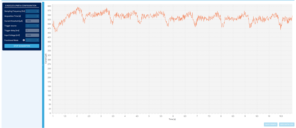

I use the nucleoWL (STM32WL which is based on STM32L4). I want to use LPWAN to communicate some measurements each day. I use I2C between MCU and sensors. If I try the Sigfox Push Button exemple, I have 2uA in stop2 mode but if I add I2C1 (thanks to cubeMX) (with any sensor yet) I have around 500uA in stop2 mode: 0693W00000JP7OGQA1.pngThat is too high...
I think that is due to internal pull-up resistors. Is it true ?
How to avoid this in stop2 mode ?

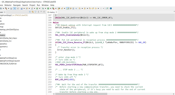

In the I2C_WakeUpFromStop2 example : 0693W00000JP7QlQAL.pngthe current drawn my the uC is around 1uA that is good for me. I think the pins are not pull up internally

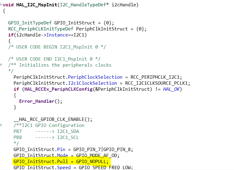

NB: the I2C pins have to be no pull according to the Init done in CubeMX:

It seems that the GPIO needs to be pulled up. I tested the Sigfox Push Button project and I noticed a drop of 500uA by setting the GPIO in pull up mode rather in no pull mode.
Let me know is this were your issue or if you solved it already.
