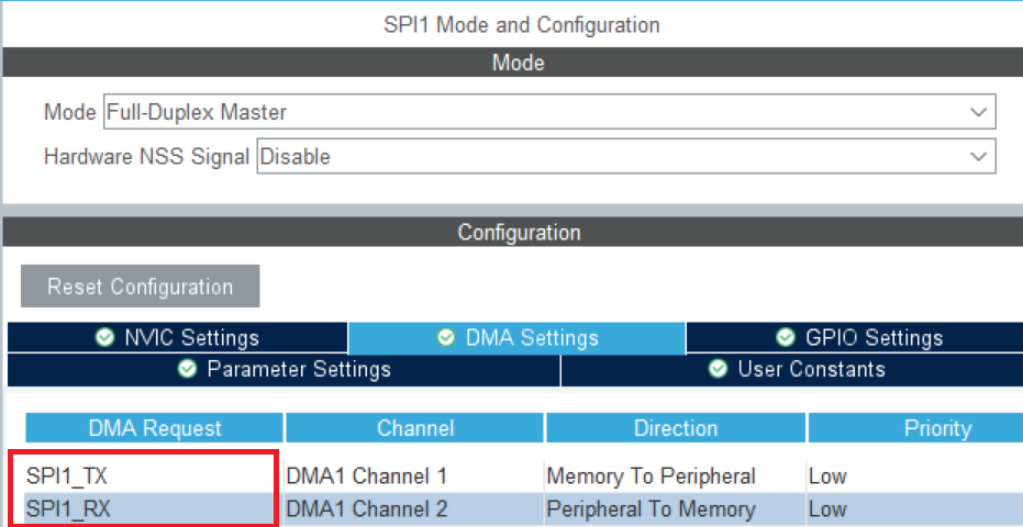

The STM32CubeMX generate:
#define LCD_SPI_Send_DMA(rd, ln)           BSP_ERROR_FEATURE_NOT_SUPPORTED
instead if I modify the generated DISPLAY/Target/lcd_conf.h with
`#define LCD_SPI_Send_DMA BSP_SPI1_Send_DMA`
seems work correctly.
I am using:
  • Nucleo WB55RG
  • GFX01M1
  • STM32CubeIDE 1.9
  • X Cube Display 2.1.0 (in the package 2.0.0 was correctly defined)
Is this only a STM32CubeMX bug or I can't use SPI + DMA+ Display?
Thanks for the support
Sara BEN HADJ YAHYA
Hello @NRoss​ ,
The BSP_ERROR_FEATURE_NOT_SUPPORTED can be removed by applying the right settings in SPI1 config.
I see that you used SPI1 interface for ILI9341, so you need to navigate to SPI1 configuration and enable both TX and RX DMA requests.
0693W00000NpgzUQAR.pngBy re-generating the code, you will get the following lines in lcd_conf.h file.
#define LCD_SPI_Recv_DMA                    BSP_SPI1_Recv_DMA
#define LCD_SPI_SendRecv_DMA                BSP_SPI1_SendRecv_DMA
I hope this helps :smiling_face_with_smiling_eyes:
