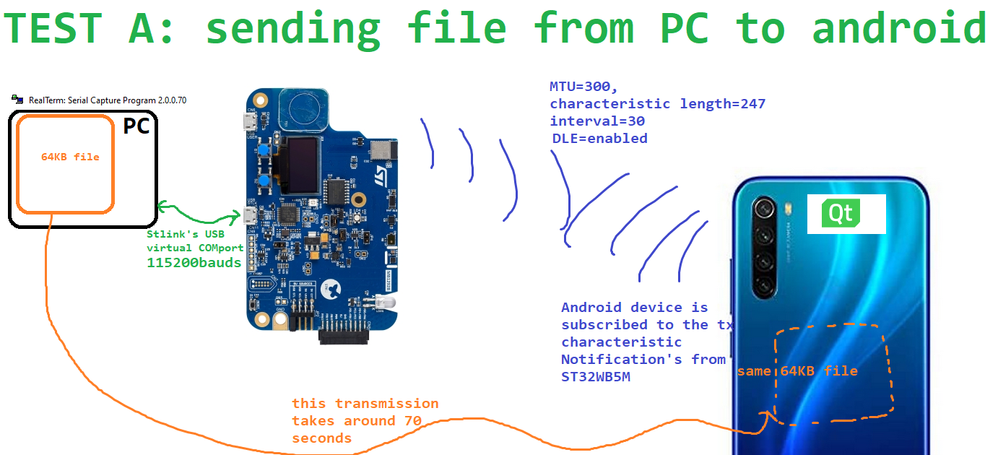

Hi i am developing a BLE-UART bridge with an STM32WB5M.
I am guetting around 1,85 KB/s data troughput, is this normal?
Did anyone pull this off with greater data troughput? (same uart thing or any streaming application)

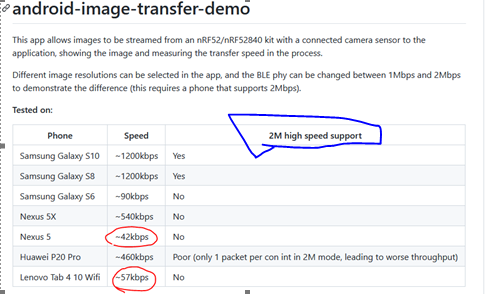

I found out the data trougput depends a LOT of the BLE chipset of the android phone/device.
My phone didnt have BLE5.0 2M high speed support.
Newer i-phones and Samsung phones/tablets would be able to archieve this data trougputs.

Increasig baudrates:
  • 115200 total transmission time= 70seconds
  • 230400 total transmission time= 70seconds
  • 460800 total transmission time= 70seconds
  • 921600 clogs the STM32WB fifos, too fast, faster than the BLE is serviced?

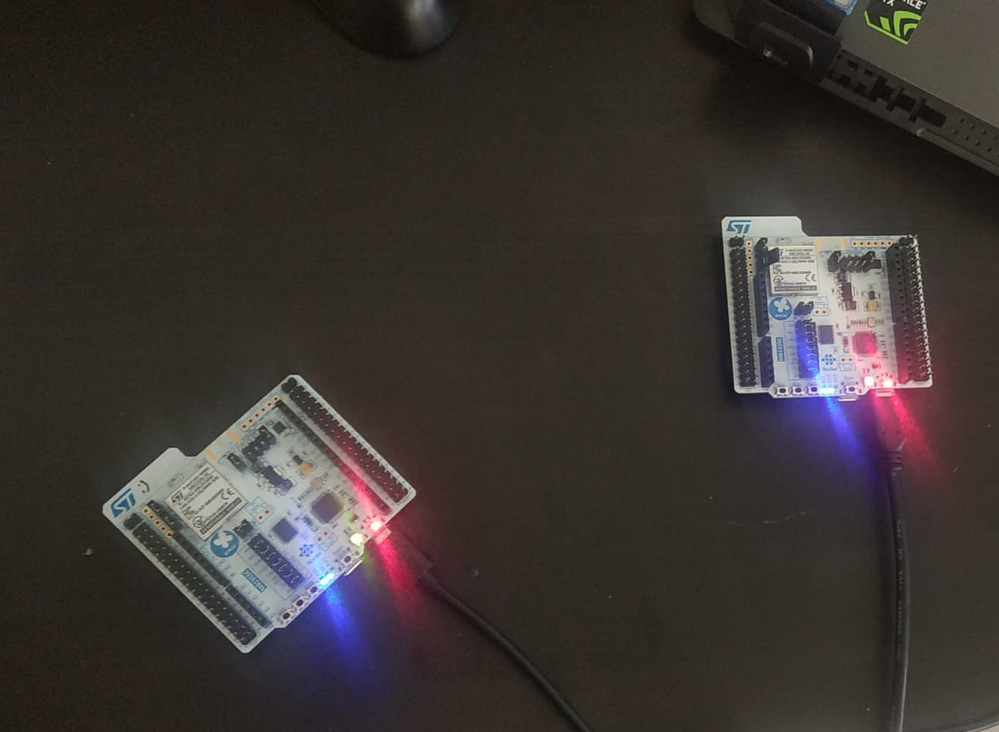

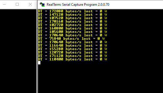

The terminal says im transmitting in between 170KB/s and 75KB/s.
Those are great news, but now i have more questions
  • Are this speeds going to be replicable with an Android deice instead of two ST modules?
  • Are we talking about "real" data? no transport layer nor GATT nor anything just the notification characteristic data?
Searching for what data is being accounted for:
inside dt_client_app.c:
static void DataThroughput_Calculation( void )
    uint32_t MoyData;
    if (Nbr_packet < 600)
      Nbr_packet++;
      TotalDataReceived += DataThroughputValue;
    if (Nbr_packet == 600)
      MoyData = TotalDataReceived / 600;
      APP_DBG_MSG("Moy = %ld bytes/s \n",MoyData);
      TotalDataReceived = 0;
      Nbr_packet = 0;
    APP_DBG_MSG("DT = %ld bytes/s lost = %ld \n",DataThroughputValue, packet_lost_local);
  static void DataThroughputTimer( void )
    DataThroughputValue = (uint32_t)(DataTransfered / TIMEUNIT);
    packet_lost_local = (uint32_t)(packet_lost / TIMEUNIT);
    DataTransfered = 0;
    packet_lost = 0;
    UTIL_SEQ_SetTask(1 << CFG_TASK_APP_DATA_THROUGHPUT_ID, CFG_SCH_PRIO_0);
    return;
 It looks indeed like its the real data troughput

Remy ISSALYS
The data throughput is smaller with an Android device than between two STM32WB because the smartphone choose the connection interval and the CE length. The peripheral can request a new connection interval (the smartphone can accept it or not) but it can't modify the CE length. You can use ST BLE Toolbox application, that allow to do data transfer measurement (uplink and downlink).
The data throughput computation is done at GATT level.
You can look AN5604 to have more informations.
