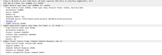

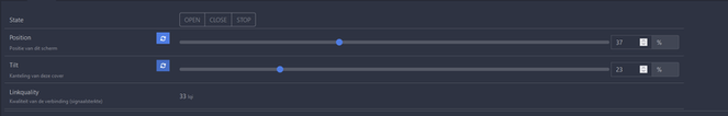

I'm trying to get a window cover to work, but can't seem to get the communication between attributes to work. I've been able to do this with the on/off cluster but this just doesn't seem to work. Also the examples on github are programmed very differently than the IDE seems to generate. I've bought a CC2531 Zigbee sniffer and can now see what's being communicated between my home assistant and the stm32 chip. When I change the position in the picture below a command is send out which you can see in the other picture.
I can see that the status is 'Unsupported Cluster Command' and I dont really know what I'm doing wrong.

STTwo-32
Hello @Hesseltjuuh
Could you please have a look at our ST examples available on the STM32CubeWB and try to understand how they are built. After that you can try to build your own code based on that. Also, you can refer to the AN5506.
Best Regards.
