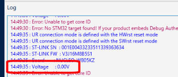

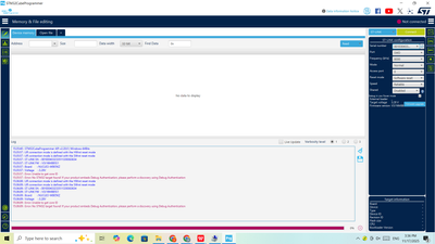

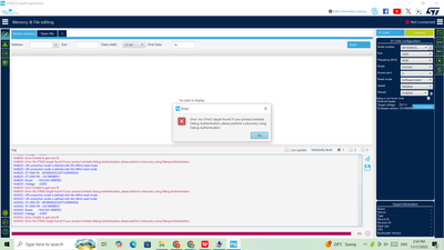

How to solve "Error: No STM32 target found!" using Nucleo-WB05kz?
Ankit1810
I am getting the same problem with my nucleowb05kz board

yes i have tried all the approaches but still getting the same problem

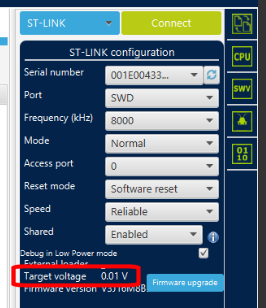

Your screenshot shows that the target is not powered:

So what did you do to fix the power supply issue?
