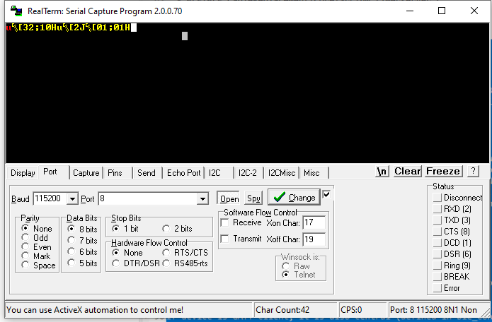

 What it actually happens is this
I type ascii "u" and the stlink answers with a weird string (nothing happens in the other module)
0693W00000F9uNEQAZ.pngOk i realised VT100 is not just a name of a serial terminal programm, this is a whole different ancient uart protocol yeey (its defined in octal)

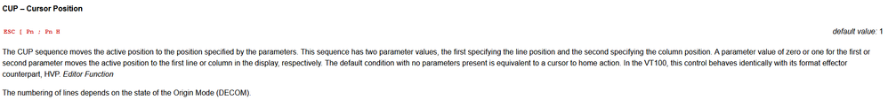

So if i send the character "t"
i would get replied "\e[32;23Ht" which kind of looks like
0693W00000F9xj3QAB.png https://vt100.net/docs/vt100-ug/chapter3.html
"e[" would be equivalent to "ESC[" (CSI)
the last H would be
Final character
   A character whose bit combination terminates an escape or control sequence.
 0693W00000F9y5EQAR.pngThe parameter string has two parameters and they get build inside this function

Now i just need to find a working windows vt100 emulator
https://www.ttwin.com/
30days free trial this should do for now

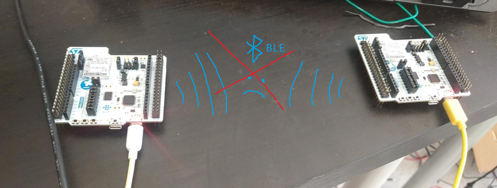

Your picture shows 2 Nucleo boards.
