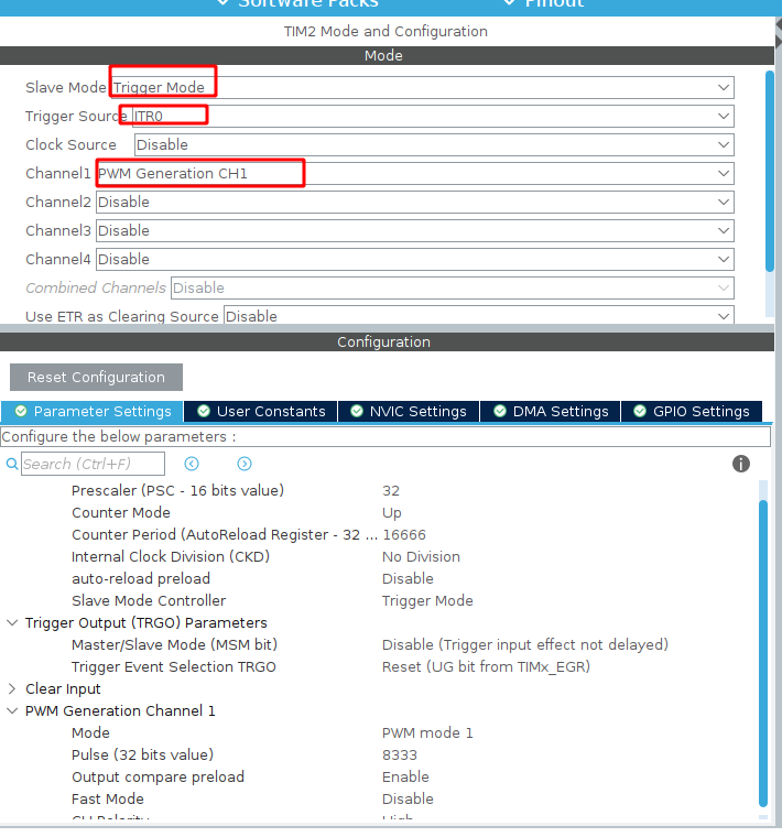

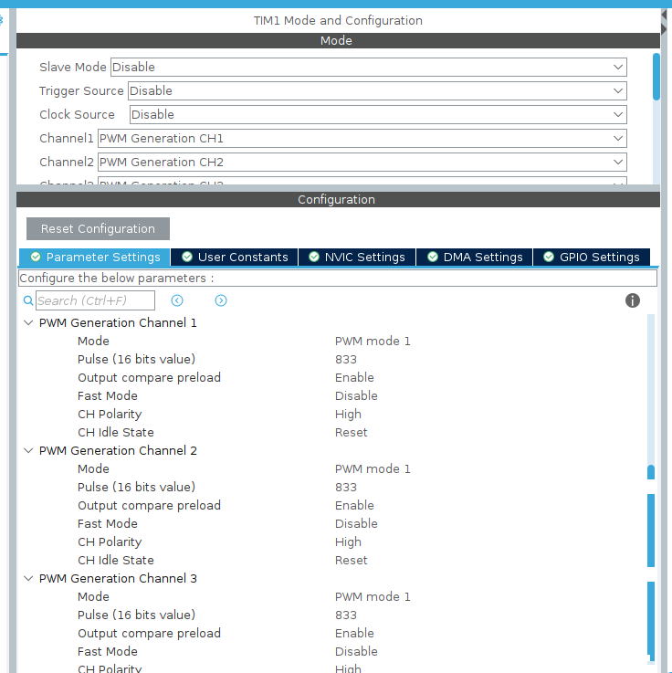

2.I used the hardware timers directly to generate the PWM signal But there is phase shift after two or three pulses
Below is the configuration for PWM using slave trigger concept.
‎2024-07-08 10:57 AM
There is a phase shift when using the timer hardware? Is this between the 3 signals from TIM1 or between the TIM1 signals and the TIM2 signal? Either way, if the timers are free running I would not expect any change in phase relationship. Are you starting or stopping the timers to toggle your "CAM_TRIG" signal?

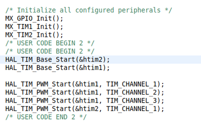

The phase shift between the timer1(three channels ) and timer2 singlechannel
- Are you starting or stopping the timers to toggle your "CAM_TRIG" signal?
A)Yes i am starting the timer base once and PWM like below
I am attaching video FYR

Your TIM2 prescaler needs to be 31, not 32. See how you set the TIM1 prescaler (64-1). The actual clock divisor is "precsaler+1".

Does it mean that changing the prescaler to 31 will make it work? I modified it later, but there is still a phase shift between the two timers' PWM.

> I modified it later
What does that mean? Fix it in CubeMX and re-gen the code. Or hand-edit MX_TIM2_Init() as a quickie test and THEN fix it in CubeMX.
WAIT - You are using TIM2 as BOTH the us delay and a PWM generator?????? NOOOOoooooooo....... First off, as @Tesla DeLorean said, don't (ever) clear the timer count value. And second, even using differential timer counts, this will fail when the timer auto-reloads from its ARR value to zero (which is has to do in order to generate the PWM). Use a different timer exclusively for your delay function, **IF** indeed you still need that us delay.
