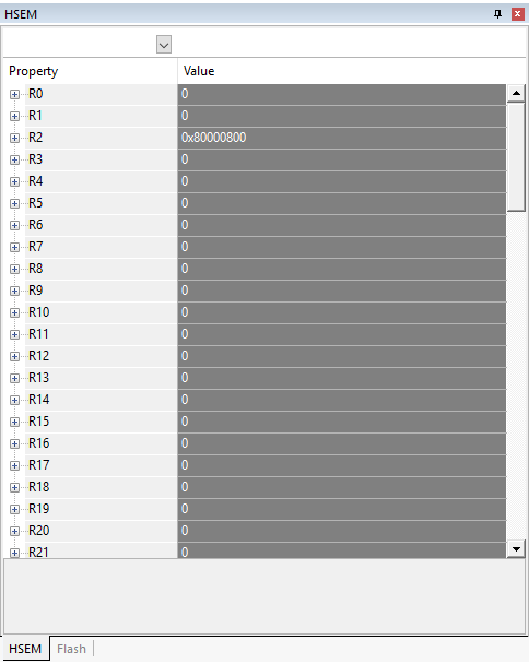

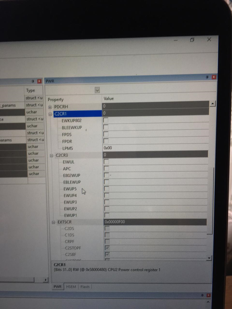

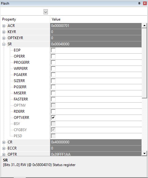

2) Always after debug is starting (i use the Keil 5.29, compiler v5.06 build 750, st-link v2 mini) after function APPE_Init() hardware semaphore HSEM2 (CFG_HW_FLASH_SEMID) always bysu and Flag CFGBSY in FLASH_SR too.
I can erase or write to flash nothing!!! CPU2 don,t release this semaphore. At the same time I can't find my BLE device via my phone and at the same time i can't enter to shutdown mode. But if i press "reset CPU" in the Keil everything is getting good. Where is finding the problem? I use full_BLE_stack v1.5 and stm32WB55CGU

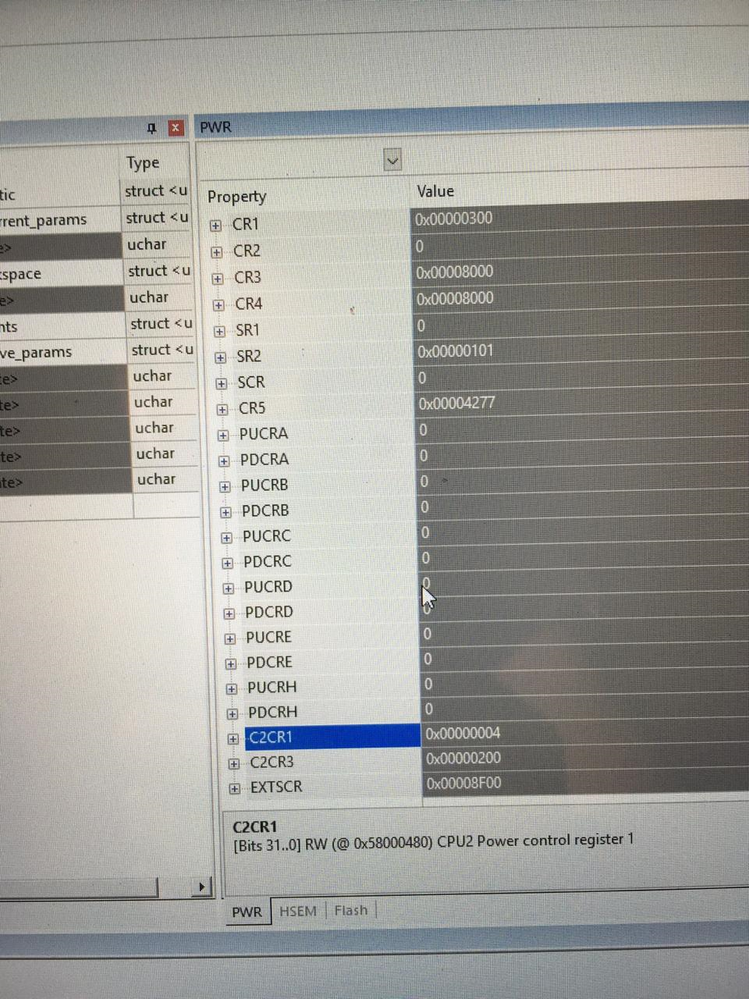

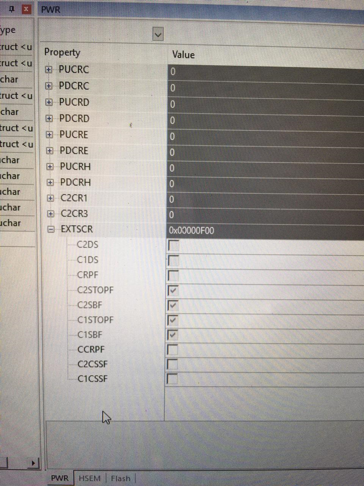

I also noticed that when I turn on the Debug at first registers PWR-C2CR1 = 0, PWR->C2CR2 = 0, PWR->EXTSCR = 0x00000F00. In this moment Hsem2 is busy CPU2 and I can't find my Bluetooth device.
But after reset PWR-C2CR1 = 4, PWR->C2CR2 = 0x00000200, PWR->EXTSCR = 0x00008F00
I think the CPU2 is freezing. Why?
