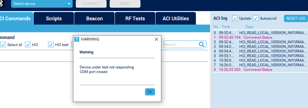

Dear Remi,
I connect JP5 DEBUG pins of Nucleo Board to CN1 DEBUG pins of USB Dongle, then use STM32cubePorg tools to Update Firmware.
When I use the example firmware: ble_transparent_mode_vcp, and connect USB Dongle on STM32CubeMoniter-RF.
It show a waring message : "Device Under the test no responing COM port closed"

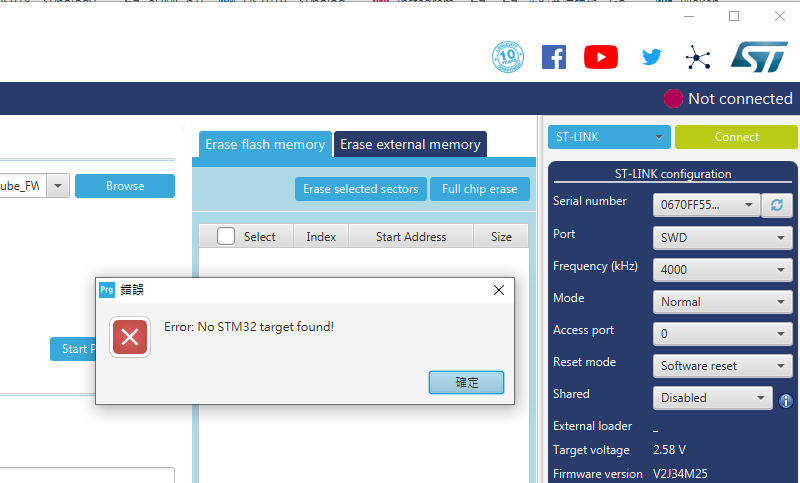

When I update back to demo example: BLE_p2pClient.
Then STM32cubePorg show a error message :"NO STM32 target found"
May I ask how to fix those problem?

2019-11-06 3:40 AM
I've met this problem yesterday. For me the reason was the nSWBOOT0 option byte set to 0, so the hardware BOOT0 switch does no change. The only way to fix this is to use SWD to program nSWBOOT0 to 1
2019-11-06 5:42 AM
Indeed but when the USB DFU mode is used this nSWboot option byte is set to 1 with the command. Moreover the start of the issue was the USB device not detected.
Anyow it is worth the trial.
If you are able to connect with the JTAG/SWD port then you can either set nSWBOOT0 to 1 as the switch setting the PH3/BOOT0 pin is properly positionned.
launching the command STM32_Programmer_CLI.exe -c port=swd mode=UR -ob nSWboot0=1
or you can launch the command STM32_Programmer_CLI.exe -c port=swd mode=UR -ob nSWboot0=0 nboot1=1 nboot0=1 regardless of the PH3 BOOT0 pin.
or directly launch the complete command
STM32_Programmer_CLI.exe -c port=swd mode=UR -ob nSWboot0=0 nboot1=1 nboot0=1 -fwupgrade %FW% %ADDRESS%

2019-11-06 6:57 AM
I've made this
-ob pcrop_rdp=1
-ob rdp=0xbb
-ob rdp=0xaa
And now I'm not able to read or write flash
I'm a bit worried it's because of SFSA is now pointing zero
