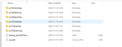

I have recently purchased the board found in this link: https://www.st.com/en/evaluation-tools/p-nucleo-lrwan3.html
I am running to a lot of issues and need some help. Firstly , where do i find the Loriot gateway lrwan3 firmware. I have a suspicion that the installed code is outdated. Secondly, the cudeID expanion pack does not have sx1278, which is what the end node uses. What would you suggest i do :

You can find the firmware of the gateway here. For the End Node, it is based on the LRWAN_NS1 that includes the RHF0M003-LF20 that uses the SX1276 radio driver.
