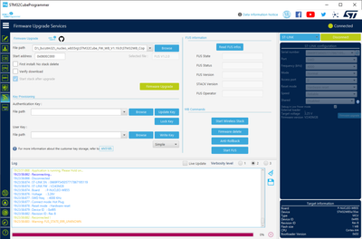

Start FUS: works
Read FUS info: works (see screenshot)
Neither firmware deleting nor Firmware upgrading is possible with my STM32WB55 Nucleo board.
Always receiving FUS_STATE_ERR_UNKNOWN.
Can you please advise how to proceed?

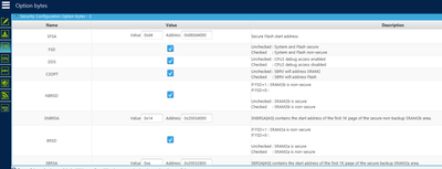

Below you can find the option bytes of the board:
STM32_Programmer_CLI.exe -c port=SWD -ob displ

Security Configuration Option bytes - 1:
ESE : 0x0 (Security disabled)
PCROP Protection:
PCROP1A_STRT : 0x1FF (0x80FF800)
PCROP1A_END : 0x0 (0x8000800)
PCROP_RDP : 0x1 (PCROP zone is erased when RDP is decreased)
PCROP1B_STRT : 0x1FF (0x80FF800)
PCROP1B_END : 0x0 (0x8000800)
Write Protection:
WRP1A_STRT : 0xFF (0x80FF000)
WRP1A_END : 0x0 (0x8000000)
WRP1B_STRT : 0xFF (0x80FF000)
WRP1B_END : 0x0 (0x8000000)
OPTION BYTES BANK: 1
Security Configuration Option bytes - 2:
SFSA : 0xD4 (0x80D4000)
FSD : 0x1 (System and Flash non-secure)
DDS : 0x1 (CPU2 debug access disabled)
C2OPT : 0x1 (SBRV will address Flash)
NBRSD : 0x1 (SRAM2b is non-secure)
SNBRSA : 0x14 (0x2003D000)
BRSD : 0x1 (SRAM2a is non-secure)
SBRSA : 0xA (0x20032800)
SBRV : 0x3D800 (0x20000000)

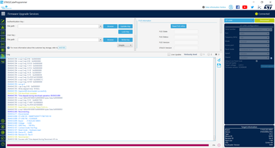

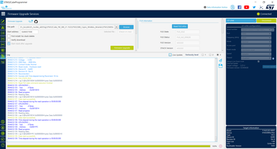

Hi @STTwo-32 ,
thanks for the quick response. Sorry, but you may haven't fully read my post "Neither firmware deleting nor Firmware upgrading is possible". I tried updating with STM32CubeProgrammer GUI:
and also with the CLI tool (see below). Seems that uploading (1.step of FUS) works but starting the firmware (2.step of FUS) always fails with FUS_STATE_ERR_UNKNOWN.
Meanwhile I read some other posts and found that FUS_STATE_ERR_UNKNOWN is maybe an issue with "ESE bit set"?
https://community.st.com/t5/stm32-mcus-wireless/unable-to-start-fus/td-p/132074/page/3
STM32_Programmer_CLI.exe -c port=swd -vb 2 -fwupgrade "D:\_bu\stm32\_nucleo_wb55rg\STM32Cube_FW_WB_V1.19.0\STM32WB_Copro_Wireless_Binaries\STM32WB5x\stm32wb5x_FUS_fw_for_fus_0_5_3.bin" 0x080EC000 firstinstall=1
STM32CubeProgrammer v2.16.0
ST-LINK SN : 0669FF545057717867195119
ST-LINK FW : V2J43M28
Board : P-NUCLEO-WB55
Voltage : 3.26V
SWD freq : 4000 KHz
Connect mode: Normal
Reset mode : Software reset
Device ID : 0x495
Revision ID : Rev B
flash loader D:/vm_cb/STM32CubeProgrammer/bin/FlashLoader/0x495.stldr is loaded
Device name : STM32WB5x/35xx
Flash size : 1 MBytes
Start Address : 8000000
Device type : MCU
Device CPU : Cortex-M4
BL Version : 0xD2
Debug in Low Power mode enabled
Download firmware image at address 0x80EC000 ...
Memory Programming ...
Opening and parsing file: stm32wb5x_FUS_fw_for_fus_0_5_3.bin
File : stm32wb5x_FUS_fw_for_fus_0_5_3.bin
Address : 0x080EC000
Memory Erase via FlashLoader!
Memory erase...
halt ap 0
Erasing internal memory sectors [236 241]
Init flashloader...
halt ap 0
run ap 0
halt ap 0
Loader sector erase...
run ap 0
halt ap 0
Download in Progress:
halt ap 0
Loader write range...
Init flashloader...
halt ap 0
run ap 0
halt ap 0
run ap 0
run ap 0
Segment[0] downloaded successfully
File download complete
Time elapsed during download operation: 00:00:00.768
Firmware Upgrade process started ...
UPLOADING OPTION BYTES DATA ...
Bank : 0x00
Address : 0x58004020
Bank : 0x01
Address : 0x58004080
PROGRAMMING OPTION BYTES AREA ...
Warning: Option Byte: nSWboot0, value: 0x0, was not modified.
Warning: Option Byte: nboot0, value: 0x1, was not modified.
Warning: Option Byte: nboot1, value: 0x1, was not modified.
Warning: Option Bytes are unchanged, Data won't be downloaded
Time elapsed during option Bytes configuration: 00:00:00.032
Succeed to set nSWboot0=0 nboot1=1 nboot0=1
Opening and parsing file: 0x495_FUS_Operator.bin
File : 0x495_FUS_Operator.bin
Address : 0x08000000
Memory erase...
halt ap 0
Erasing internal memory sectors [0 1]
Init flashloader...
halt ap 0
run ap 0
halt ap 0
run ap 0
halt ap 0
halt ap 0
Init flashloader...
halt ap 0
run ap 0
halt ap 0
run ap 0
run ap 0
Time elapsed during download operation: 00:00:00.411
Application is running, Please Hold on...
Reconnecting...
Disconnected
Voltage : 3.26V
SWD freq : 4000 KHz
Connect mode: Hot Plug
Device ID : 0x495
Revision ID : Rev B
Reconnected !
Error: FUS_STATE_ERR_UNKNOWN: Unknown error
Error: fwupgrade Command Failure!

Hi @STTwo-32,
Start FUS + Read FUS infos always work,
but Firmware upgrade + Start Wireless Stack always fail with FUS_STATE_ERR_UNKNOWN.
