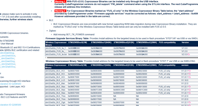

Have you followed those warning will updating the Wireless stack after updating the FUS to the version V2.0.0:
  • Warning 1: With FUS v2.0.0, Coprocessor Binaries can be installed only through the USB interface,
    Currently CubeProgrammer versions do not support “FW_delete” command when using the ST-Link interface. The next CubeProgrammer release will address this limitation.
  • Warning 2: For Coprocessor Binaries marked as “FUS_v2 only” in the Wireless Coprocessor Binary Table below, the “start address” provided by CubeProgrammer under “Firmware upgrade services” must be corrected as follows: start_address = (start_address - 0x4000). However, addresses provided in the table are correct
If not, it may be the reason behind this issue.

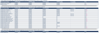

hello @STTwo-32 . thanks for your answer. but i did like that.
and another problem un html file.
file names are too long to show in the table

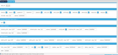

and where I can find default option bytes? It would be great if possible to set default in cubeprogrammer.

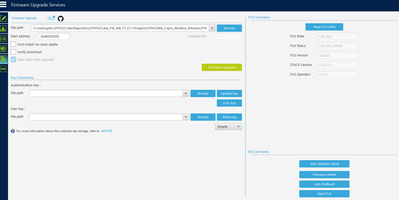

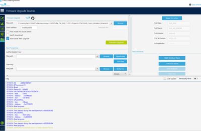

it worked for a short time. but after connecting stm32cubeprogrammer and see "Firmware Upgrade Service" and read FUS info, It is not working anymore. why it is not reliable. I did not anything. after programming flash again, it works. but it is not working again. :(
After Clicking on the read or start FUS. Or update the Wireless binaries, could you please try to click on the "start Wireless Stack" button .

nima.askari
I did all steps again. Should I press "Start Wireless Stack" after updating stack? I pressed this time and now it is working.
But after pressing "Read FUS infos", it does not work anymore.
I think "Read FUS infos" erases my flash. but why
After updating the stack, you may need to click on "Start Wireless Stack" button.
