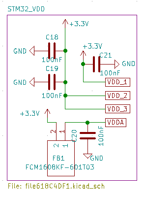

Hi guys,
I recently made a design based on nucleo wb55 dongle using STM32WB55CGU (48-UFQFN), but I cannot connect to it using SWD.
I believe it is not a schematic problem, so I am a bit stuck for debugging the situation. I soldered it using hot air station (< 250/260 deg celsius). The joints look okay, but I am not an expert on soldering QFN. So, my main guess is that I broke it while soldering.
- Is it really feasible to solder it using hot air station ? or a reflow oven is a must ?

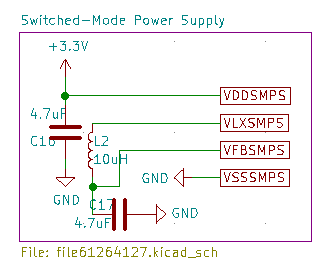

- I compared the voltage on the dongle with my custom board, and the difference I find is on pin VLXSMPS, and VFBSMPS. It is 3.3V on dongle, but 0V on mine. What could be the reason ?
- It is not shorted to GND.
- I tried to short it to VDD, but it didnt help
- NRST is at 3.24V
- I use the ST-Link V2 to program it, same as what I use on the dongle
Thank you very much for your time

Soldering a QFN with a hot air gun is very doable, but takes some amount of skill/experience. STM32 chips are quite robust. It's hard to damage them from temperature. Use flux, you should see it shift into place when solder begins to flow.
‎2021-08-23 3:54 AM
Thank you for your message. That's how i did it actually. Would you mind having a quick look at my schematic if you have some time please ?
Thanks again​
‎2021-08-23 11:05 AM
I did. Seems fine to me but I'm not an expert with SMPS configuration. I would assume a fresh chip is configured to run in LDO mode for any relevant option bytes.
