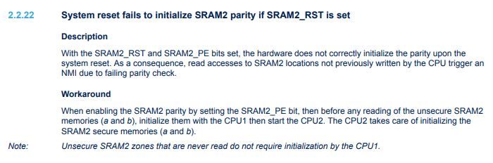

I updated my application from the "full" to the "full extended" BLE stack 1.13.3.
I modified the link file as requested in the release note.
My issue is that if I keep the SRAM2 parity enable my application crash in NMI error. When I disable the parity it is OK.
This issue was fixed by with stack 1.13.0 "full" but seems to be back it "full extended" variant.

You can look the errata sheet ES0394, see the following extract:

Thank you , you are right, I configured the section MB_MEM2 as a no_init section to reduce starting time. It works fine with 1.13.3 full but not with 1.13.3 full extended.
Adding a manual initialization of MB_MEM2 to 0 before starting the core 2 solved my issue.
