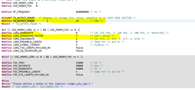

We're using the STM32WLE5JC to develop a LoRa-based project. We are looking into testing our sensor in a very specific environment with very specific settings - the TX power and Spreading Factor. Can these two be manually configured?

2024-10-18 3:40 AM
Hello @helixembedded
Yes, you can change those two parameters on the "subghz_phy_app.h" file of your project:
Best Regards.
STTwo-32
