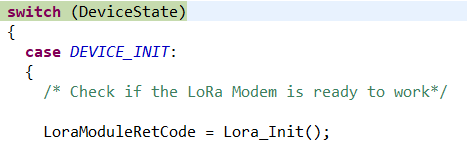

Everything is working fine until the program gets to the AT+DR command. There a Hard Fault occurs and it gets stuck in a forever loop (default handler).

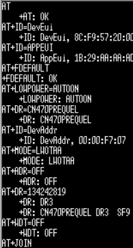

I tried to isolate the problem using the debugger. When the program reaches the switch(DEVICE_STATE) statement, the hard fault occurs. The problem is that I can't get the debugger to enter this switch statement, but it does enter, as various AT commands are being printed after the switch, and before the hard fault.

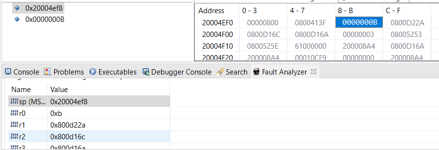

I tried to get infos on this hard fault, but the analyzer does not provide me any clue. I can only get the SP register value and I have not enough knowledge to get any useful info out of it.

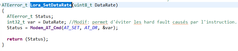

Found a solution !
Apparently for no reason, it can crashes on the AT+DR command. To solve the issue, you just have to change the Lora_SetDataRate() function as follow :

>>Apparently for no reason...
No, for a reason you haven't established.
Looks to be alignment, or access via the pointer modifies something out of scope.
Might see similar errors for sscanf()
