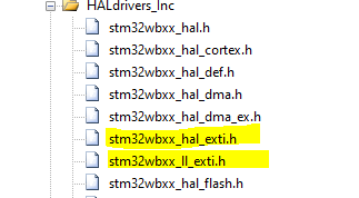

I see 2 types of drivers.
one are under ll , e.g., "stm32wbxx_hal_exti"
and one under hal e.g., "stm32wbxx_ll_exti"
Why are there two types for each?
Can EXTI C2EMR2 be configured via the hal drivers and not the ll drivers?

Hello @Community member​ ,
The HAL and LL have their own include files defining what they need.
They are complementary and cover a wide range of application requirements:
  • The HAL offers high-level and feature-oriented APIs with a high-portability level.
  • The LL offers low-level APIs at register level, with better optimization but less portability.
I advise you to refer to this user manual UM2442 to have an overview of HAL and LL drivers, and how to use the given API to build your application.
