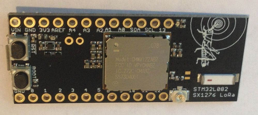

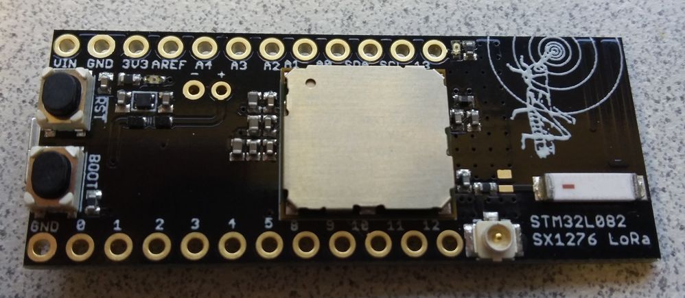

    The Grasshopper boards also arrived today, shipped very quickly/efficiently. The 5 dBi antennas arrived as well.
    Tesla DeLorean
    Guru
    September 1, 2017

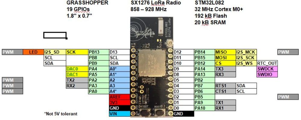

    Posted on September 01, 2017 at 22:25
    Ported code to the Grasshopper, had to change TCXO enable to PH1.
    PB13 is LED
    Schematic looks to be wrong, SWDIO is D8, SWCLK is D9
    DFuSe 3.05 doesn't seem to work properly with the STM32L0
    USART2 works on PA2/PA3, hooked that up for debug telemetry, equivalent to B-L072Z-LRWAN1 discovery board.
