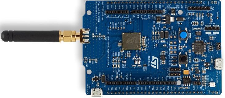

LoRa Discovery Kit
Posted on April 05, 2017 at 22:40
LoRa Discovery Kit
STM32L072 and LoRa Discovery Kit featuring Open LoRa module by Murata using STM32L072CZY6TR MCU
0690X00000603YpQAI.jpghttp://www.st.com/en/evaluation-tools/b-l072z-lrwan1.html

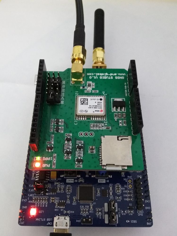

In order to evaluate the range I built two nodes, one which pings location every second from a GPS shield, and a second that receives that data from a fixed antenna.
Posted on April 11, 2017 at 22:17
So with a relatively low effort test (used good antennas, but didn't clamber up towers or onto the roof), I got fixes out to 3000ft (915m)
This was with the 14dBm (25mW) TX_OUTPUT_POWER setting. With a better antenna and placement on the vehicle the line of sight was 1.77miles (2850m). The next build of the software I'll try the 20dBm (100mW) setting.
