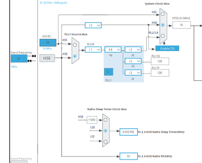

While I was going through the CubeMX configuration, I saw that two timers are configured (TIM3 and TIM16). What is the use of TIM16? It seems to stabilize the System Clock. I could not figure out why it is necessary and why ARR is chosen to be 3200.
Also, I could not find the usage of TIM3 in the code.
In case I choose to use RTOS, I want to run the system at max speed (100MHz), is that possible with the change in the code from CubeMX? I ask so because there are several clocks / timers that have certain hardcoded values (TIM16).

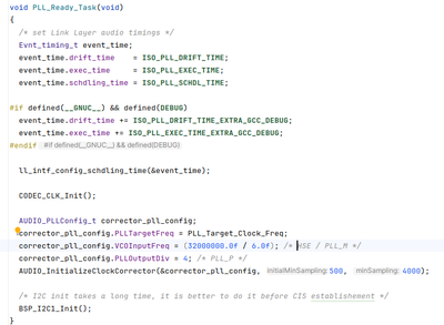

In this function, why is the PLL_M set to 6? Since, in CubeMX, it displays the divider value as `\1` .

You are right, TIM16 is used by the system clock manager when starting the HSE oscillator, especially after a low power period. Note that when running the PLL, stop and standby mode could not be used anymore and HSE is never stopped, so TIM16 is not required anymore.
Then I agree with you that TIM3 should be free in the .ioc  since audio projects are not using it.
We decided to align the strategy of the BLE_Audio_PBP_Source with other BLE Audio projects where the system is starting in low power mode (stop or standby, no PLL), and where the audio frequency (=PLL configuration) is depending on the remote device. That is why the PLL is not configured in cubeMX (but could be for PBP source), but is configured after an asynchronous event of the audio stack.
Keep in mind that the closest audio compatible frequency to 100MHz is 98.304MHz (suitable for 8, 16, 24, 32 and 48kHz on the I²S) and values provided in PLL_Ready_Task() are provided for this setup.
