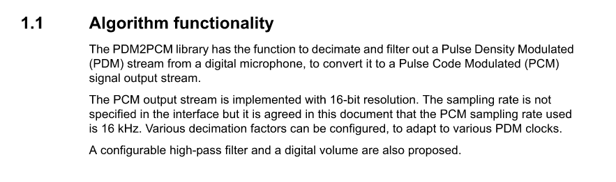

But we didn't use any CMSIS DSP now. We just use PDM to PCM library provided by STM.In the user manual mentioned as algorithm was implemented with 16bit resolution.Is there any other solutions to do get 32bit data from that library.0693W00000FDAT5QAP.png
