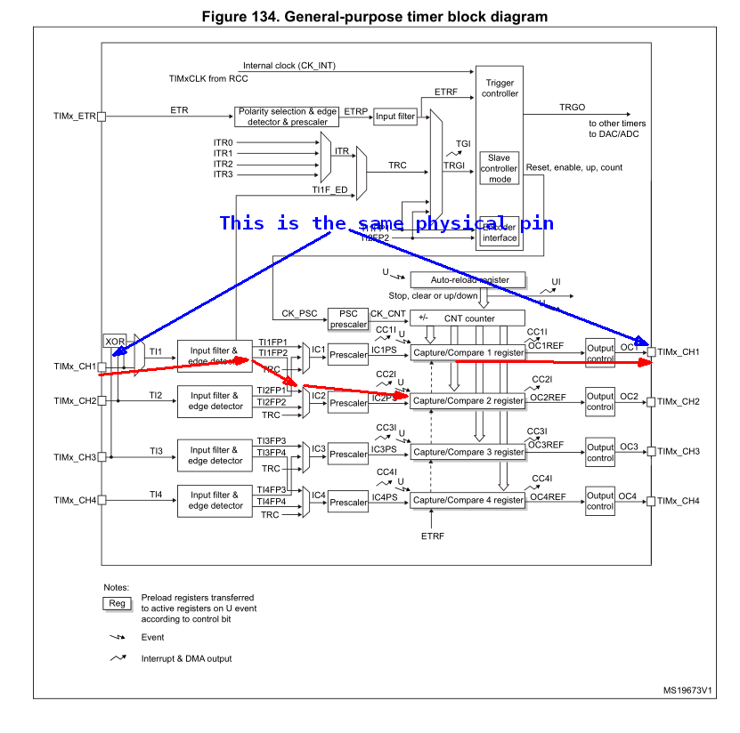

I am trying to do single-channel touch-sensing without using the TSC. For that, I put a weak pull-up on that pin. In a cyclic process, I make the pin OUTPUT-LOW, then release it and measure the rise time through Input Capture. It's a very basic test application, and I have successfully done it on many other controllers including BlueNRG-2. Unfortunately, I am not able to do the same in this.
Through various measures, I have confirmed that the user application loses control of the pin as soon as the corresponding timer (associated to the pin for Input Capture) is enabled, no matter what Pin-Timer combination I use.
Does anyone have any idea how to bring the control back to the user application with the Input-Capture enabled?
Please note, I am configuring the controller and all its peripherals, including the Input-Capture Timer, through the latest version of STM32CubeMX.
Any suggestions on how to resolve this is highly appreciated.
You can't. When pin is connected to TIM, it is in Alternate Function state set in GPIOx_MODER; whereas for GPIO output you'd need to set it to Out in MODER.
‎2020-01-10 4:58 AM
But maybe you can use a trick, using TIM's Compare as a means to output, and Capture on the adjacent channel.
‎2020-01-14 3:48 AM
Thank you, waclawek.jan, for the suggestion.
It worked!
