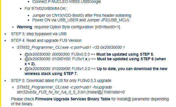

_legacyfs_online_stmicro_images_0693W00000bhdrmQAA.pngAs per STEP 4, the FUS version should have been read irrespective of anything, but when I erased the chip completely am not able to read the FUS version via USB.

Do you know how to enable the cortex M0+ before reading the FUS version via USB?
Mkuma.7
Or In other way of asking, Is there any way to start FUS without making the nswboot0 = 0 via USB?
