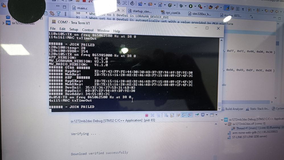

IMG_20230929_153601.jpgHi
I'm trying to connect I-NUCLEO-LRWAN1 with Nucleo-L073RZ to gateway bt it's not getting connected.
Thank you for your reply.
I have changed the board to B-L072Z and  it's working fine .

Hello @Yuvi ,
I would suggest you adding more details to your post with your current settings, hardware configuration, software version used. So, we could provide you better help about possibilities what could be wrong.
Check pins and jumpers configuration in the UM1724,
Did you follow the available example with expansion software : \Projects\NUCLEO-L073RZ\Applications\LoRaWAN\LoRaWAN_AT_Master\STM32CubeIDE\I_NUCLEO_LRWAN1\
