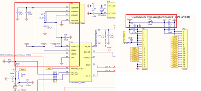

I tried to design a board using the STM32WLE5CCU6, so I referred to the reference designs MB1720,1842,1848, etc.
However, I confirmed that the VDDRF part, which is the part specified in the data sheet, is open with the SB connector.
I searched for the reason why this happened, but I couldn't figure it out, so I'm looking for help in this community.
Why are VDDRF and VDD disconnected?

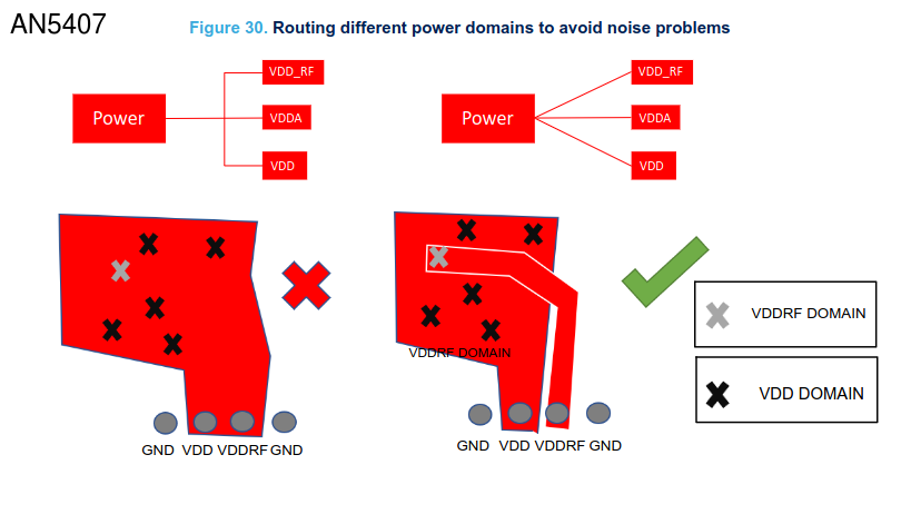

Best answer by RhSilicon
Check the AN5407, it's very annoying to work with RF.
