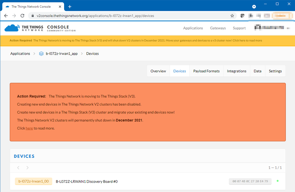

What was known as "The Things Network" (TTN) is now "legacy" and not accepting any new devices, gateways, or applications.
Thus, I think, all ST materials referencing "The Things Network" are now obsolete & unusable.
So, has anyone managed to migrate anything based on I-Cube-LRWAN to the new "Things Stack" aka "V3" ?

A lot of other material besides STM32 is obsolete as well, transition has not been seamless. I can't say much for I-Cube-LRWAN, but the STM32WLE examples/package can be made to work on the new TTN stack. The new stack does require you to enter more information about your application, including the LoRaWAN MAC version. Finding this part out can be tricky, but I found it to be V1.0.3 for the STM32WLE.
Other than this and some other extra info, the connection between your device and the TTN server should still be largely the same, so hopefully you can get your old application to work with some minor tweaks in the application. Make sure to use the verbose output in the live data view.

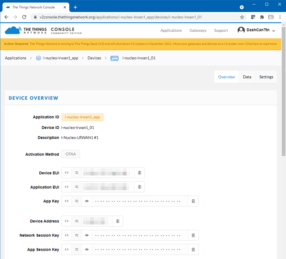

We still need a guide on how to configure all the TTN credentials into the se-identity.h configuration options in v2.0.0 of  I-CUBE-LRWAN.
These are different from v1.3.1 - they don't even seem to work with the "legacy" TTN V2.
@Amel NASRI​  "If this is still not enough to make your nodes work properly with TTN, please let me know"
No, I'm afraid it's not.
Specifically, these are the configuration parameters presented on TTN (V2):
And these are the configuration parameters available in  se-identity.h:
Please provide a list giving, for each of the settings in  se-identity.h, which of the values from the TTN Console (both V2 and V3) should be used.
#define LORAWAN_DEVICE_EUI
#define LORAWAN_JOIN_EUI
#define LORAWAN_DEVICE_ADDRESS
#define LORAWAN_APP_KEY
#define LORAWAN_NWK_KEY
#define LORAWAN_NWK_S_KEY
#define LORAWAN_APP_S_KEY

"Please provide a list giving, for each of the settings in se-identity.h, which of the values from the TTN Console (both V2 and V3) should be used"
Well, that would be for ABP (Activation By Personalization) - so instead (or additionally?) instructions for OTAA (Over-The-Air Activation) would be good.
OTAA is preferred by TTN: https://www.thethingsindustries.com/docs/devices/abp-vs-otaa/
