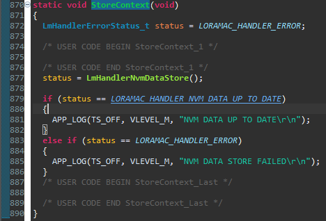

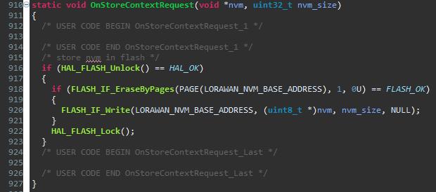

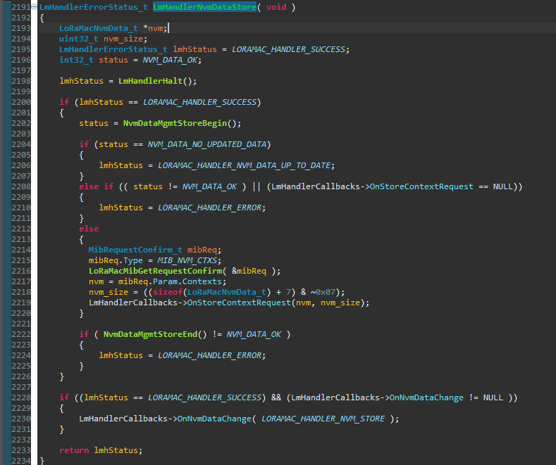

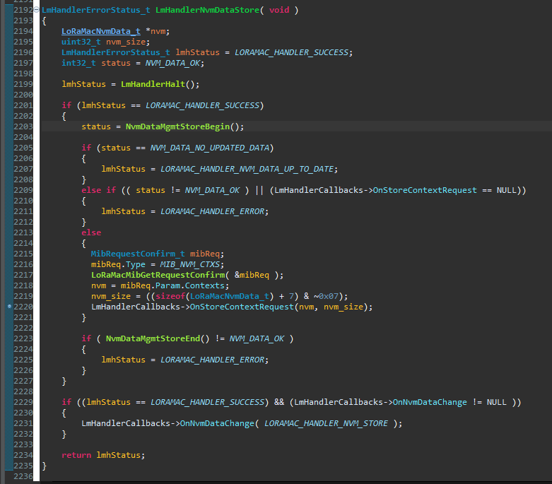

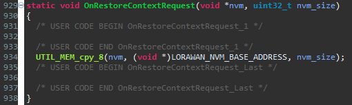

Okay. So, now I know that which parameters are required to store and retrieve such that we don't have to send a join request every next time. My query is how can I implement this thing in STM32Cube IDE? I am using the "LoRaWAN_End_Node" example and STM32WLE5JC micro-controller. There are some built-in functions that I think are to implement the subject but the example maybe not using those functions and that's why I am unable to send an uplink without a join request.
Here are some snaps of the those functions:
It would be great if you can highlight the particular thing in "LoRaWAN_End_Node" example so that I can make changes accordingly. I am new to STM32 and LoRa, your brief reply would be of great help.
