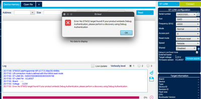

I bought ST-LINK/V2 from a certified reseller, and I have WIO-5E mini with STM32WL5JC from [Seeed.com](https://Seeed.com) on the board. This WIO-5E was already programmed by another ST-LINK/V2. I connected WIO-5E to ST-LINK as required. I want to reprogam WIO-5MINI using this programator. But STM32Programmer answered:
0693W00000YA1JoQAL.pngWhat should I do so STM32Programmer will see STM32WL5CJ from the WIO-5E mini board?

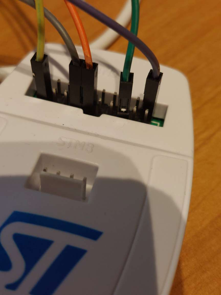

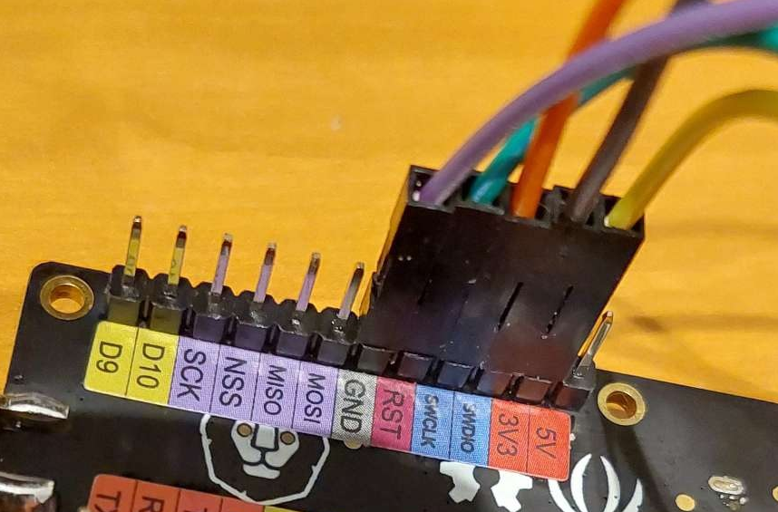

Steps to attach WIO-5E mini to ST-LINK.
Wire connections:
ST-LINK
1 => VCC
7 => SWDIO
9 => SWCLK
15 => NRST
20 => GND
WIO-5E pins mini should be connected to pins with the same names as for ST-LINK.

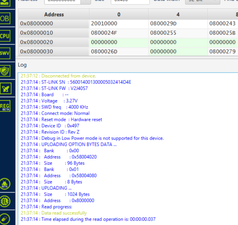

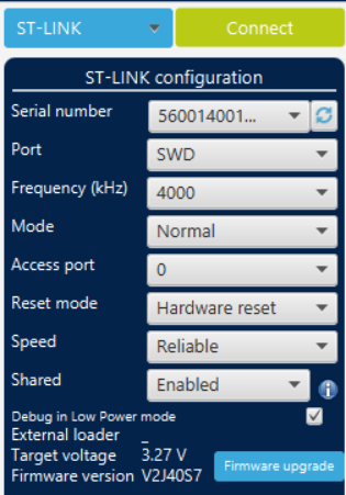

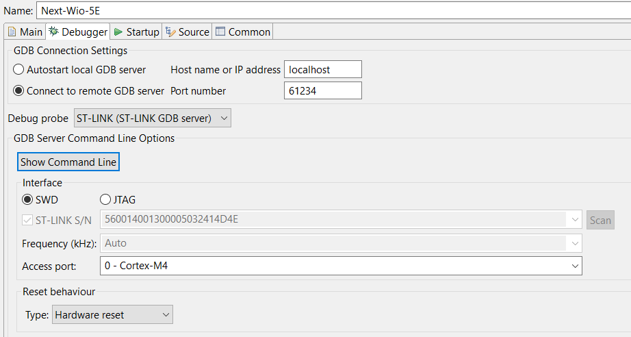

0693W00000YAIKjQAP.pngOpen the STM32Programmer, press the button Connect (look at settings before)
0693W00000YAIJ3QAP.pngYou should see the following response (without another serial number for the ST-LINK).

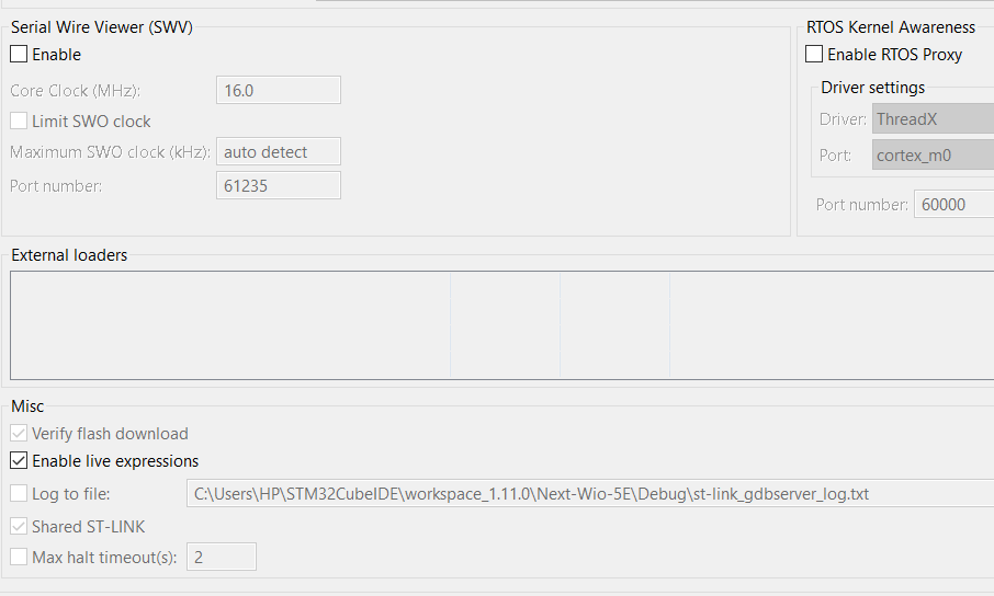

0693W00000YAIMQQA5.pngSo next, run STM32CubeIDE, go to option Run => Debug configuration, switch to de Debugger tab.
Do the following steps:
  1. Click on the Shared ST-LINK checkbox.
  2. Press the ST-LINK SN checkbox and press the Scan button. The textbox should be fulfilled with the serial number of the ST-LINK programmer.
  3. Press on the Show command line button. Copy that command into the command prompt and run it.
  4. Press on the Connect to remote GDB server radio button
  5. Press the Apply button.
  6. Press the Debug button.

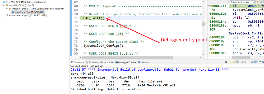

0693W00000YAIPFQA5.png0693W00000YAIPPQA5.pngAnd finally:
The end of the story.
PS. Next time, when you will try to debug, don't forget about point 3 from the above list.

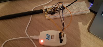

Hello everyone , i followed up the conversation after a week of research i can't fix my problem.
here my setup :
here my logs:

How  can i reboot to the builtin state.
 Impossible for me to connect back with my stlink v2.
Can someone help me to find out my problem many thanks in advance.
