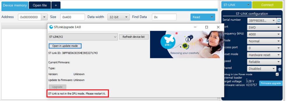

I can't.
0693W00000YA2oIQAT.pngWhat should I do to upgrade the firmware?
@Peter BENSCH​

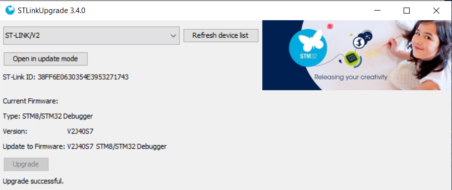

I upgraded the firmware with a stupid trick. I unplug the USB cable from ST-LINK, count for up to 6 sec, plug the USB into it, count again for up to 6 sec, and press on upgrade firmware button.
0693W00000YA5GoQAL.pngFirmware upgraded to the requested version.
But still can't connect to the WIO-5E mini. Still the same message:
Error: No STM32 target found!

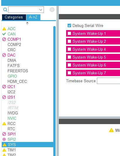

@AScha.3​ ​ Here is my view:
0693W00000YAA2IQAX.pngIt looks completely different from your's view.
But I can't understand the relation between the configuration of an application and trying to connect ST-LINK to WIO-5E mini (with STM32WL5JC chip on the board)

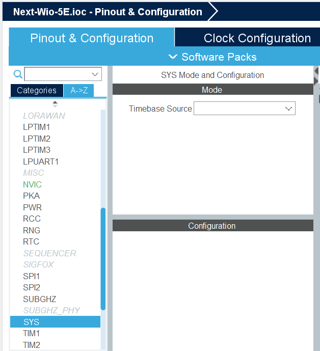

AScha.3
ok, (pic was from F072 cpu) , on your WL5x cpu the relevant pins can be set to different functions, if you want SWD debug connect, you must set PA13 + PA14 to SWD+SWC function. otherwise they will do, whatever is set to them.
if you just want flash/load program, maybe you should try bootloader mode and flash this way.
