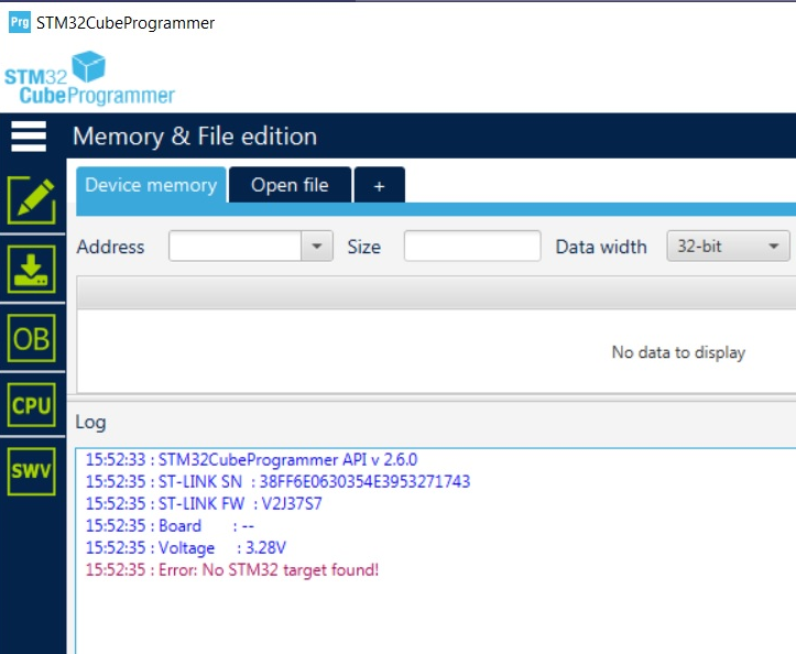

I bought ST-LINK/V2 from a certified reseller, and I have WIO-5E mini with STM32WL5JC from [Seeed.com](https://Seeed.com) on the board. This WIO-5E was already programmed by another ST-LINK/V2. I connected WIO-5E to ST-LINK as required. I want to reprogam WIO-5MINI using this programator. But STM32Programmer answered:
What should I do so STM32Programmer will see STM32WL5CJ from the WIO-5E mini board?
2023-02-05 02:53 PM
Get a current version of STM32 Cube Programmer, v2.6.0 is a bit old

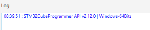

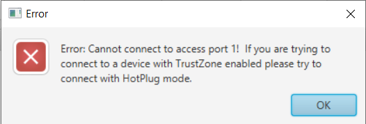

2023-02-06 12:04 AM
I upgraded to the latest version.
Then I tried to connect with normal mode and I get the message
When I changed to HotPlug mode and pressed the Restet button on the WIO-5E mini, the programmer responded with several messages:
