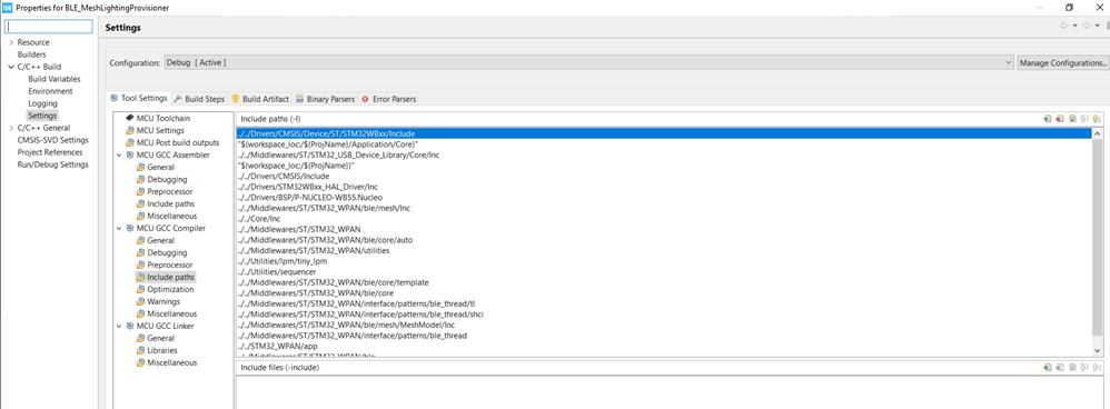

=======================build setting ==========================

/*------------------------------------Issue------------------------------------------------*/
It is responding to below read condition:
if(HAL_GPIO_ReadPin(Door_Port,Door_Pin)== GPIO_PIN_RESET)  {}else{}
but Callback function not responding to associated external interrupt..
Let me know if i missed anything to initialize the GPIO pin interrupt...
