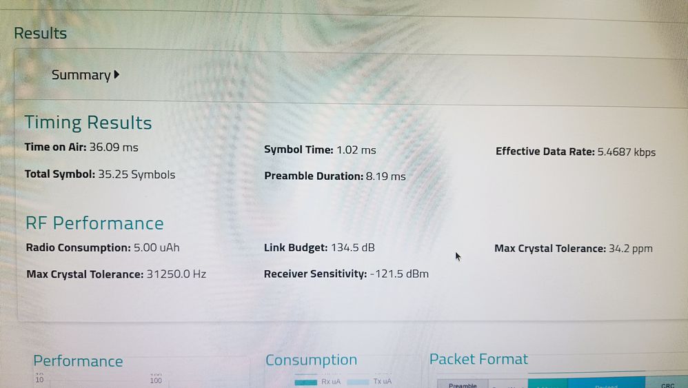

But it's not helping me. I want to transmit 25000 data frames per minute.
I'm using stm32 BL072Z Lorawan node board. Currently I'm able to transmit 28 frames per minute.
Is there's any more modifications that I can do into code about data rate or bandwidth ?

For these conditions you have chosen the absolutely wrong type of radio channel
For the Lora radio channel you can see
Semtech LoRa Calculator https://www.semtech.com/design-support/lora-calculator
and estimate what maximum data rate you can achieve

As of calculator I'll get 5.4kbps and that's around 324000 bits per minute .
And this no. Of bits per second will do the work.
But how can I manage atleast that speed of 5.4kbps.
Yuvi
Senior
I'm getting 28 frames per minute.
Each frame of 16 bytes, that's around 1792 bits per minute.
