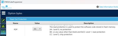

How to erase STM32WLE5JC so that I can put my binary in the Seeed Studio Wio-E5 module. Web says changing the lock bit from hex value of ??? to ???. Where can I set it? TIA

2024-04-08 7:36 AM
From ST Youtube, connect ST LINK, open STM32CubeProgrammer. Connect, click OB on left. The RDP is displayed. Below is tested on Nueclo STM32F401RE, AA is open, BB prevvents reading of flash. BB can change back to AA with auto erase flash. CC is permanant lock. Cannot change back to AA and CANNOT write new code to flash
