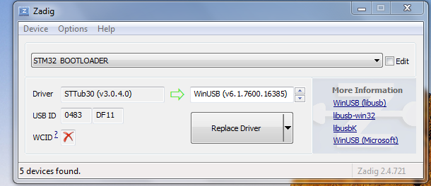

Im new for STM32 controller. I purchased cmwx12zzabz-078 Lora module which is integration of STM32L082 and SX1276 module.

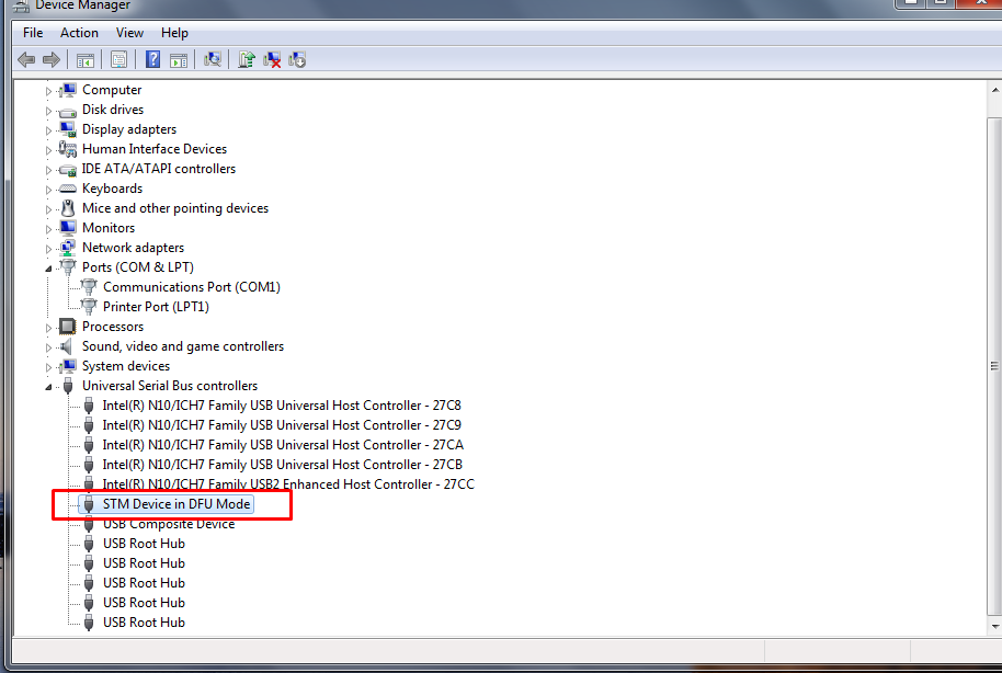

when i connect this module its showing in device manages as "STM device in DFU mode".
I followed some steps from here but its not working...
https://www.dronetrest.com/t/zadig-drivers-for-cleanflight-betaflight-stm32-flight-controllers-dfu-mode/2719/13
In Zadig software its showing as "STM32 BOOTLOADER"
I intalled WINUSB(libusb) dirver in it through Zadig only. installed successfully.
then its showing like following in device manager..

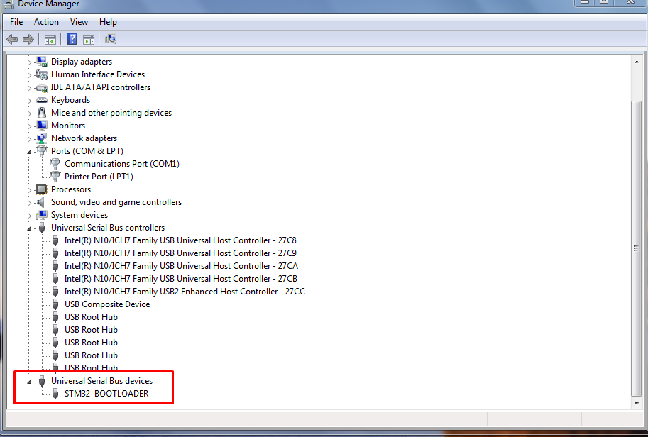

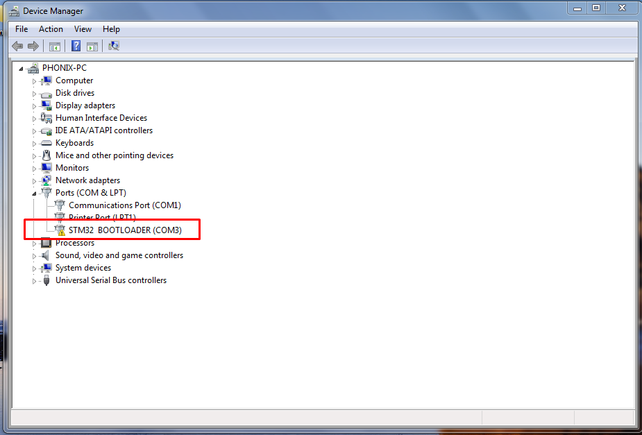

i unistalled this drivers and upload WINUSB(Microsoft) dirver in it through Zadig only. installed successfully.
i tried so many things.. but not working.. can have any link to guid me steps by steps

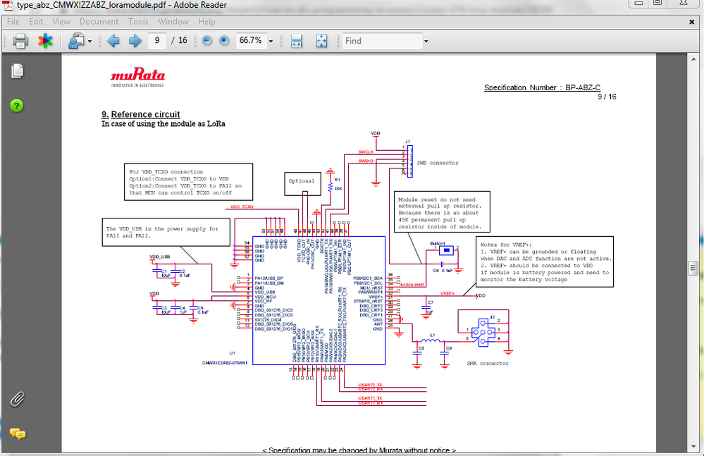

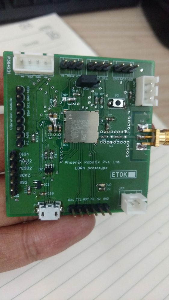

we made one customized board using following reference circuit from module datasheet
Our board is looking like this
link of product and datasheet
https://www.murata.com/en-sg/products/lpwa/lora#lora3

Well the good news is that the chip and USB interface appears functional.
The applications you mention seem to have found the device, and should permit the download of firmware. Not sure why it was necessary to use all of them, but whatever. I would have used the STM32 Cube Programmer software as this also supports USB connectivity, and downloaded a test firmware to exercise the USARTs from that.
Your board schematic would have been more helpful than Murata's.
Check what you have actually built.
Make sure BOOT0 is in fact pulled LOW, because the behaviour suggests it is not.
Test the SWD debug interface. Compile, download and debug code in Keil, look at the state of the processor. Check what code is executing.
