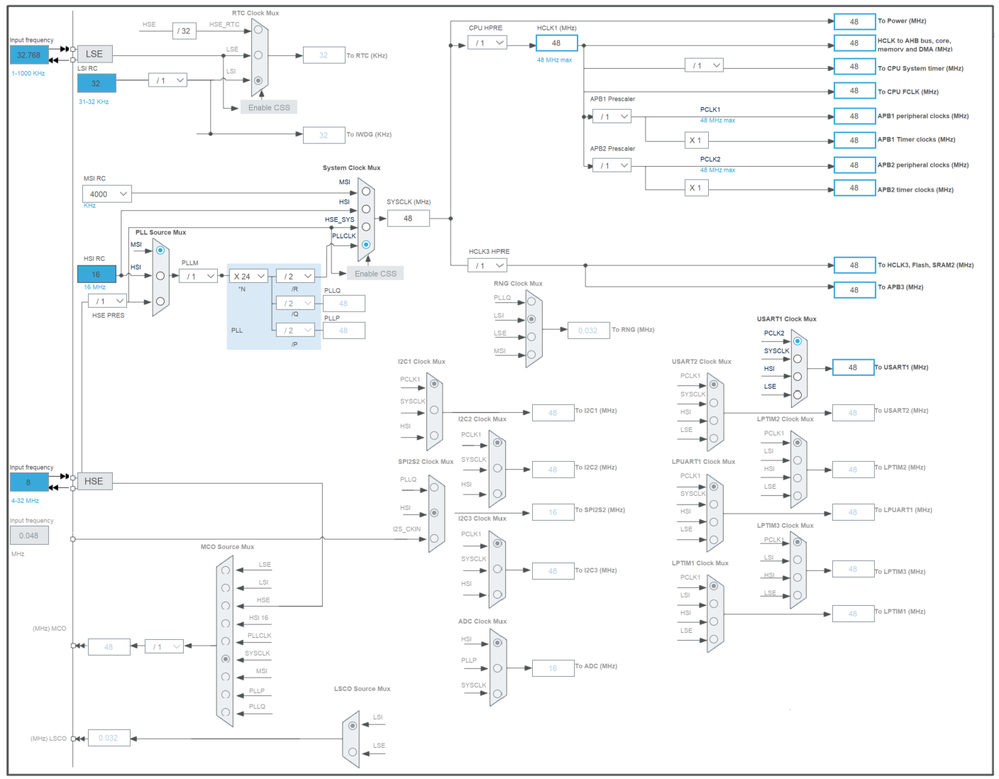

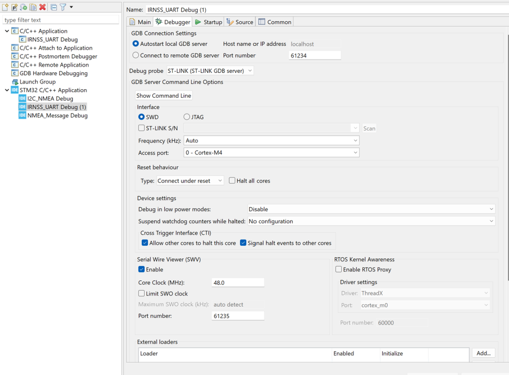

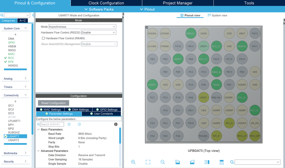

Pin configuration and the settings are as follows:
Clock configuration:
Debugger configuration:
