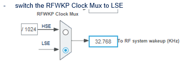

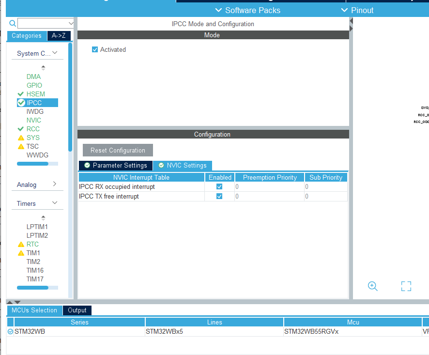

How do I build a simple Nucleo WB55 project that advertises and connects with CubeMX 6.2.1?
‎2021-04-21 8:03 AM
I built the project with CubeMX 6.2.1. I have added the call in main to the sequencer. I have added the sequencer header file. I have added the IPCC IRQHandler functions to stm32wbxx_it.c.
The project builds fine and downloads to the NUCLE0 WB55. It starts up and advertises as expected but it will not let me connect to it.

‎2021-04-22 11:33 AM
CubeMX 6.2.1 takes care of the IPCC functions that used to require being added buy hand:
We also needed to make sure that we were using LSE for the RF system wakeup:
After making these changes, everything works as expected.
