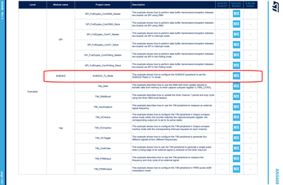

Hi Andrew,
Thank you for the recommendation, I will also give this a go
Of course, it should still be possible to use the WL55 with non-LoRa modulation - but I've not tried that ...
Does this help: https://forum.digikey.com/t/using-the-low-level-sub-ghz-radio-driver-for-the-stm32wl-series/18253 ?
https://www.st.com/en/embedded-software/stm32cubewl.html
https://www.st.com/resource/en/application_note/an5409-stm32cube-mcu-package-examples-for-stm32wl-series-stmicroelectronics.pdf
Hi all,
I have edited the Ping Pong example to suit my needs. In it, I can specify to use FSK modulation instead of LoRa, with the USE_MODEM_FSK flag. This provided the basic FSK setup and I could play with the FSK_FDEV, FSK_DATARATE, and FSK_BANDWIDTH to reach a payload data rate of 64 bytes at 20 Hz. Thank you all for your help!
