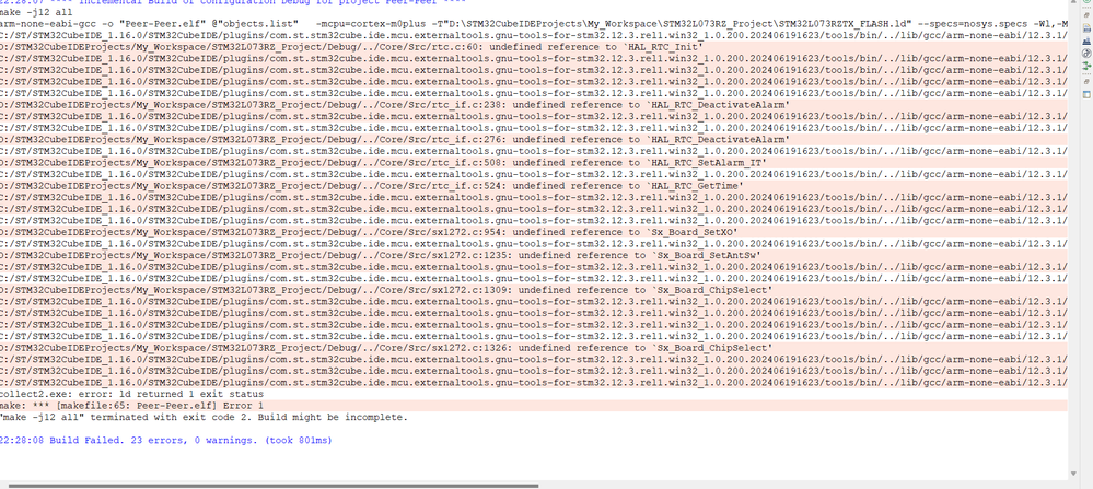

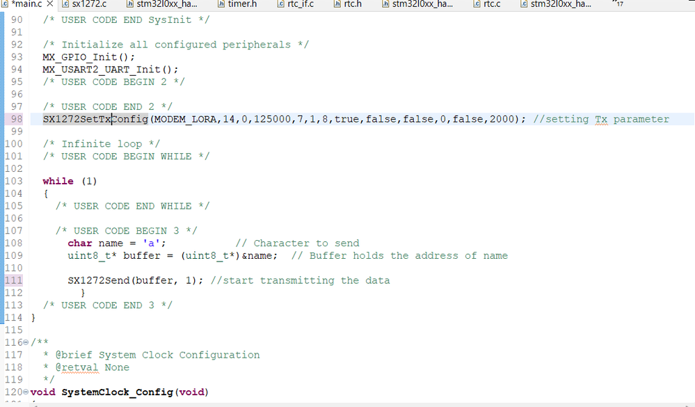

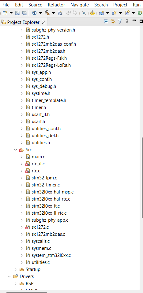

I am working on a point-to-point communication project using the P-Nucleo LRWAN2 board package. In this setup:
  • The NUCLEO-L073RZ acts as the transmitter.
  • The NUCLEO-F746ZGT6 acts as the receiver.
I have downloaded the LoRaWAN package for STM32Cube provided by ST, but I am facing difficulties using the library in STM32CubeIDE.
Here’s what I’ve done so far:
  1. I created a new project in STM32CubeIDE.
  2. I started copying the .c and .h files from the LoRaWAN package into my project.
  3. I included the necessary header files, but I am still getting "undefined reference" errors during the build process.
Could someone guide me on the correct way to integrate the LoRaWAN library with STM32CubeIDE? I’m not sure if I’m missing any specific configurations or additional steps to properly set up the project for point-to-point communication.
Thanks for your help!Inc and Src FolderInc and Src Folder

First, the NUCLEO-F746ZGT6 on the P-Nucleo LRWAN2 board package is not configured to work as a local node for a P2P application. It is used as a Gateway for LoRaWAN applications. So if you arr looking for a P2P application, you should use two NUCLEO-L073RZ from the Kit. For that you can find a ready to use application (P2P) on the I-Cube-LRWAN.
You have to know also that thos product are obsolete and not recomanded for New design. So, if you are looking for the new generation of ST Long range products, i suggest you to use our STM32WL series that System-On-Chip integrates both a general purpose microcontroller and a sub-GHz radio on the same chip. It supports modulation such ask LoRa, Gpsk,... Also, it came with two evaluation boards (Nucleo-WL55JC1 and Nucleo-WL55JC2) and a SubGHz module. It came also with a full package of Middleware, drivers examples,... Called STM32CubeWL
Best Regards.

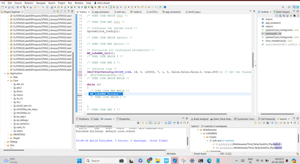

Hello
Thanks for your help, I am configuring the wrong files previously due to that I encountered error in .c and .f file. One thing I have to ask more, I am configuring NUCLEO-L073RZ board as end node using end node project in the lora package. In the main.c file there is a default function "MX_LoRaWAN_Process()" how to implement this function.Screenshot 2024-08-20 042222.png
