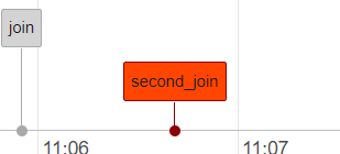

I hope you are doing well. I wanted to follow up on a recent inquiry regarding the disconnection and reconnection of a LoRaWAN node from a gateway.
Thanks to your valuable assistance, I've successfully managed to join the LoRaWAN network and send data from my node to the gateway. However, I've encountered a challenge when attempting to disconnect and then reconnect the node.
Here's a breakdown of the issue:
  1. Disconnect Command Behavior: When I issue the ATZ or AT+RFS command to reset the node, it indeed resets, but upon trying to rejoin the network, I receive an "EVT JOIN FAILED" response. Meanwhile, on the gateway side, it shows a second join attempt.
  2. Need for Clean Disconnection: I understand the importance of properly disconnecting the node from the network before resetting it. However, I'm unsure about the correct sequence of commands or procedures to ensure a clean disconnection and subsequent reconnection without encountering issues.
