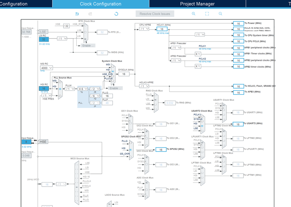

I have attached the system clock & I2S configuration:

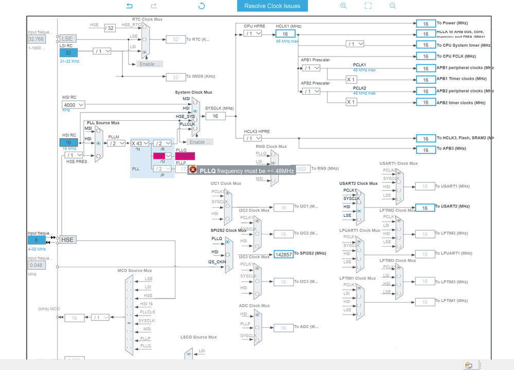

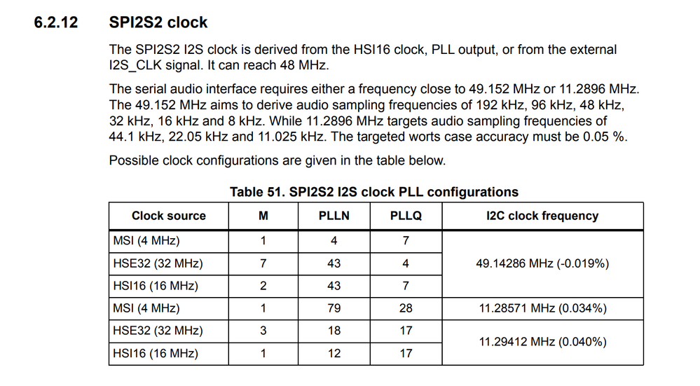

I read the STM32WL-RAK-3172 reference manual. In that manual list out the frequencies based on the I2S communication (PLL clock configurations). I tried to the set the PLL clock in cube IDE clock configuration, but I didn't able to set the PLLQ clock source.
Forcefully I tried to set the PLLQ Clock, but the -warning is shown in the configuration.
If I enable the PLL CLOCK, that time I2S didn't worked. I can't see any output in the serial monitor, if enable the PLL clock.

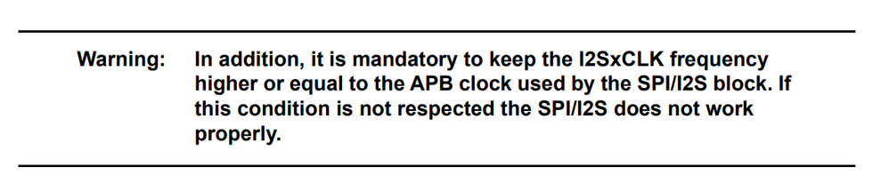

0693W00000aJAxyQAG.png0693W00000aJB04QAG.pngSome warning is stated in that reference manual. I attached the warning massage screenshot below:
0693W00000aJB1vQAG.pngSo I changed the I2S clock same like in APB clocks.
0693W00000aJArIQAW.png​That time also the song didn't play in actual CD drive frequency 44.1khz.It only noise sound is produced in the speaker.

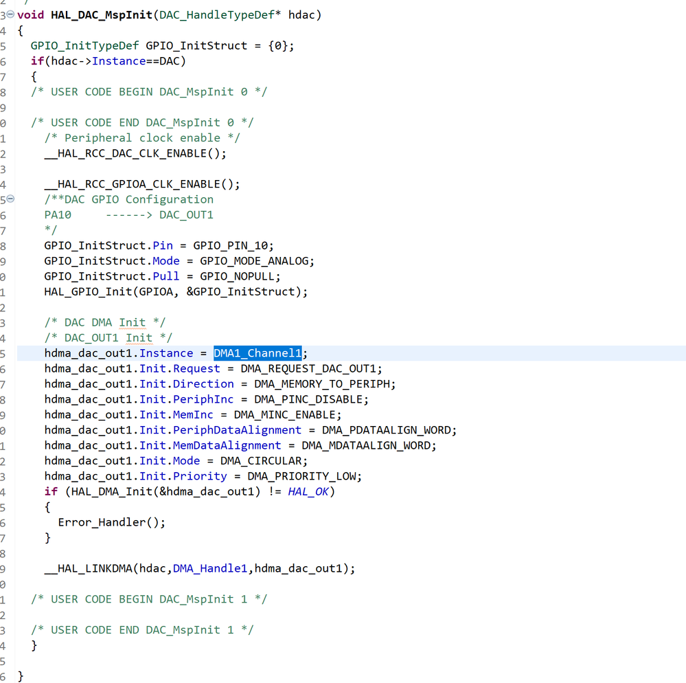

I also attached the DMA configuration below:

Your DMA is for the DAC peripheral, which has nothing to do with I2S, as far as I know.
Clock:
Take a calculator and modify the given values to get closer:
For example, take 8 MHz HSE, then set M = 2, PLLN = 79, PLLQ = 14,
then you should get 22.57 MHz.
In the I2S peripheral you have to set the prescaler accordingly, depending on its oversampling factor.
  • as LCE said: wrong DMA -> DAC ; set DMA -> I2S ...better chance to work.
  • got PLL ON ? for 48MHz clk or so .
  • in I2S (in Cube) can set the sample rate you want; did you set it there?
